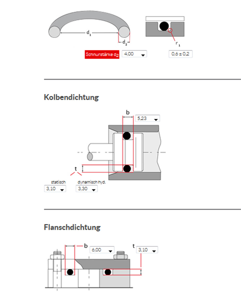

        Hi, I am using rubber rings Ø 4mm. Here it is necessary to precisely maintain the dimensions of the grooves where these rings will be installed.Click image for larger version

          What website are you going to for this information firma555? Looks like a good reference.
            Doing a quick search I found several o-ring calculators, here is one https://o-ring.info/en/tools/o-ring-groove-calculator/
