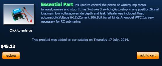

          Has anyone had issues ordering from Arkmodel directly recently?
          I went to order my Ballast Control Unit (BCU) today and received a HTTP ERROR 500 when going through the checkout process.
          Does anyone know where I can order one or something similiar other than Arkmodel?

            I haven't tried their site in years. They have been putting things up on ebay and are even selling through Amazon. They have always delivered as promised. Also, as you can tell from the instructions, their english is very poor.

              Thanks Bob.
              I bought the kit through Amazon a weeks back with no issues. Unfortunately I tired to find the BCU on Ebay, Amazon, and the internet in general with no luck.
              I was wondering if I could find another unit made by a different company, or use something different in its place?
                • 347
                That is a very unique controller, looks almost as nice as a Engel controller.

                    If you don’t get a response from Arkmodel, send me a PM. I have a BCU for their Type 212 that I’m not planning on using. We can probably work something out.
