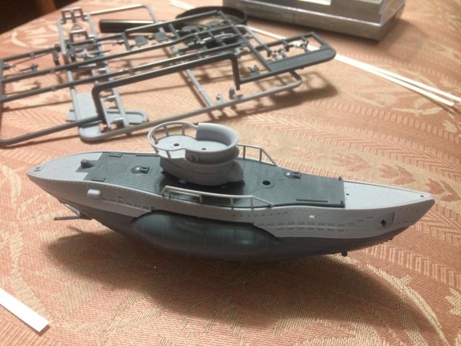

    I started a new Submarine the Meng U-Boat Type VII Build.

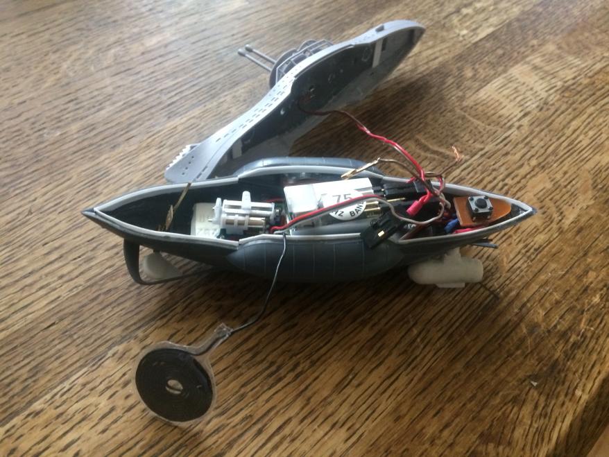

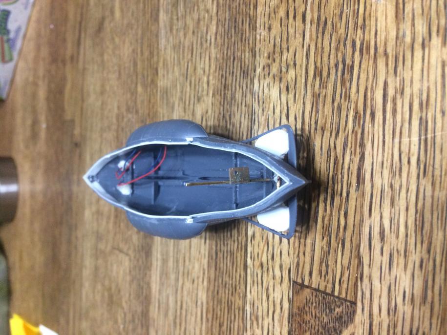

    The sub is a bit small so i am building this sub with two nacelle drive motors.

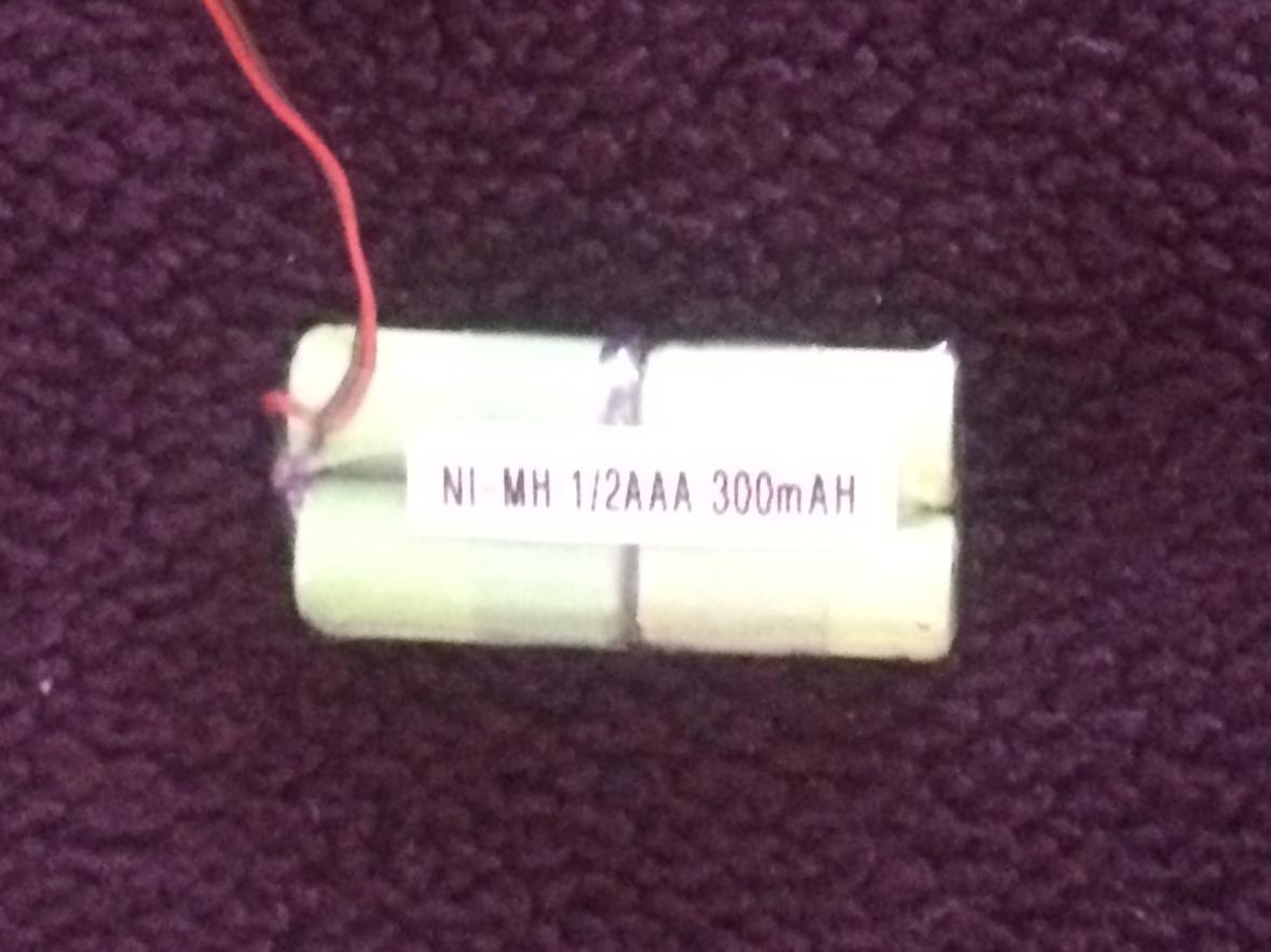

    Custom made battery pack 4.8v, 1/2 AAA.

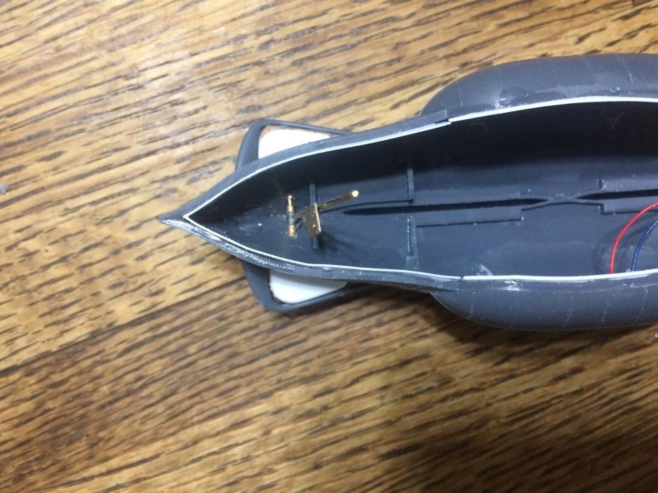

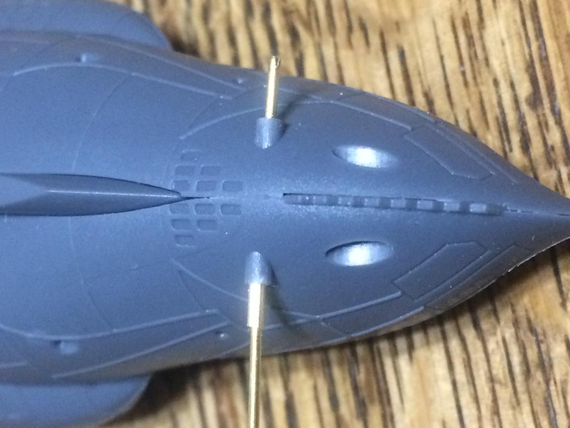

    The sub will have front control surfaces.

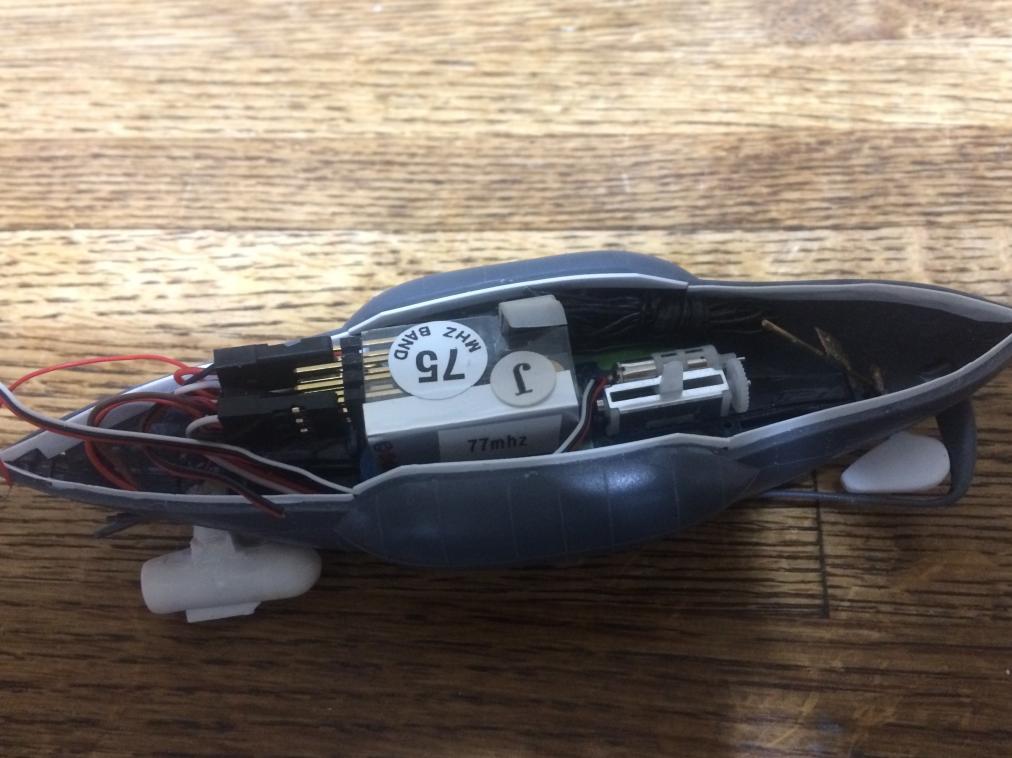

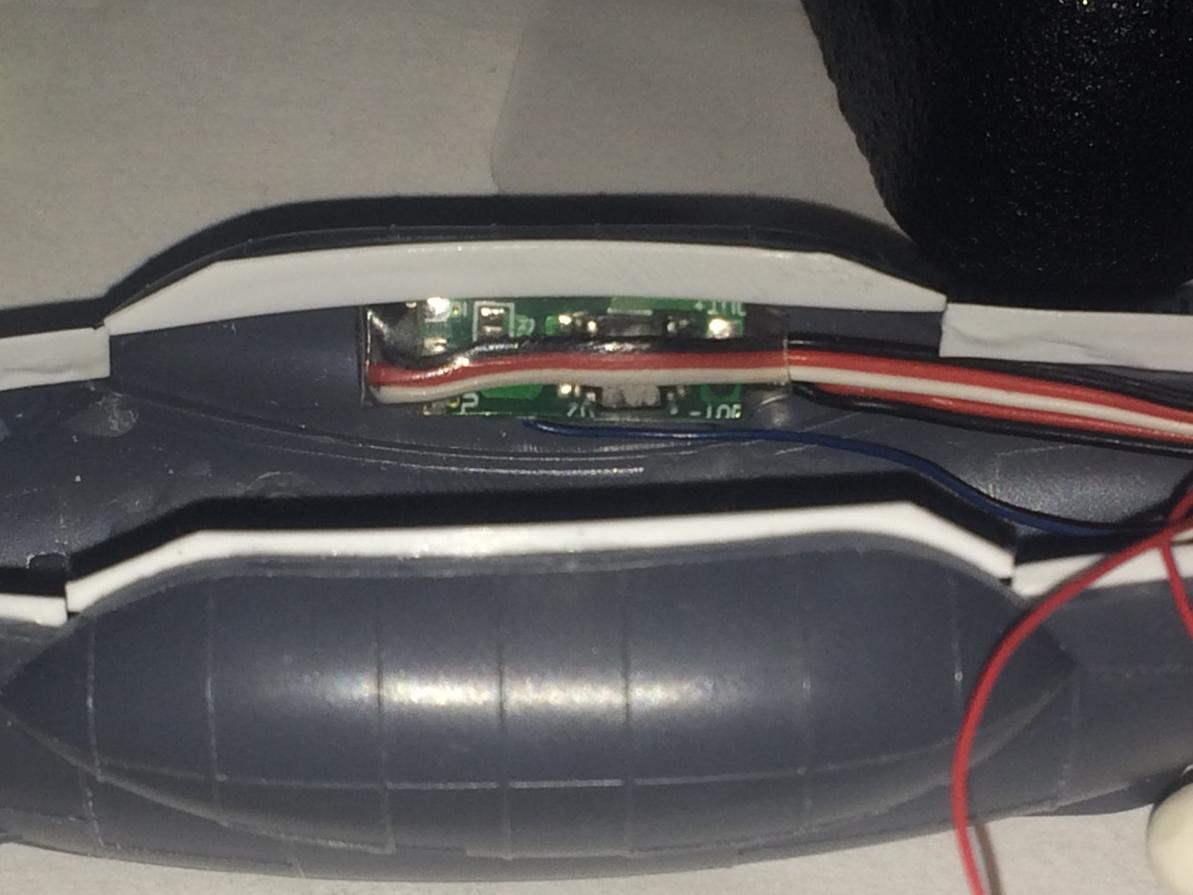

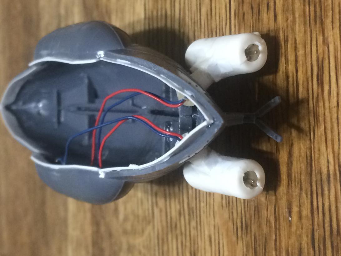

    Components and component placement
    there are two ESC one in each saddle tank
ID:	137570 Click image for larger version
ID:	137571 Click image for larger version

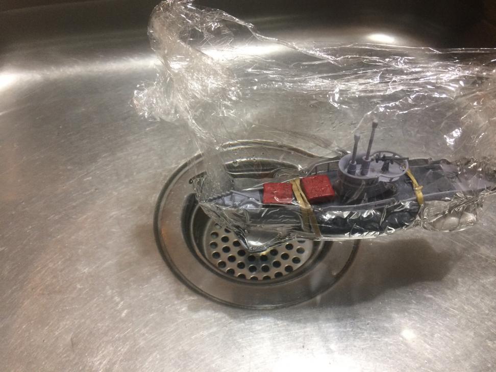

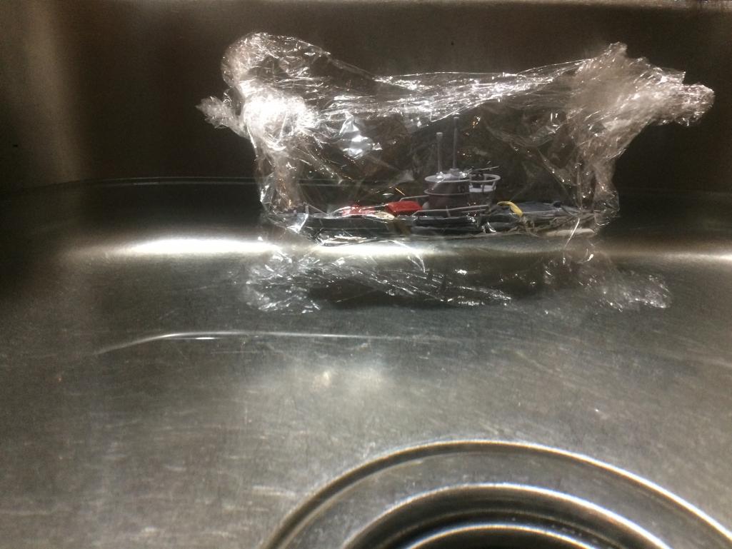

    I place the sub in the water to determine the amount of weight 1/2oz fore and aft. Place it in plastic to determine water line.
ID:	137574 Click image for larger version

      I see some really cool ideas there! Tell me about the way you wrapped the antenna, how do you do that and range.
      Thank you!
      • mar7ck
        • 198
        Hey Jeff,
        thats what my gurrl says and i have to tell you like i tell her... IT'S MANISH!!!
        Small sub guy
        • mar7ck
          • 198
          Hey Tom,
          When i do a range test i'll let you know. I wrappedthe antenna wire it in a circular motion on a peice of packing tape.
          it won't need to go that far because if the Sub's size.
          Small sub Guy
