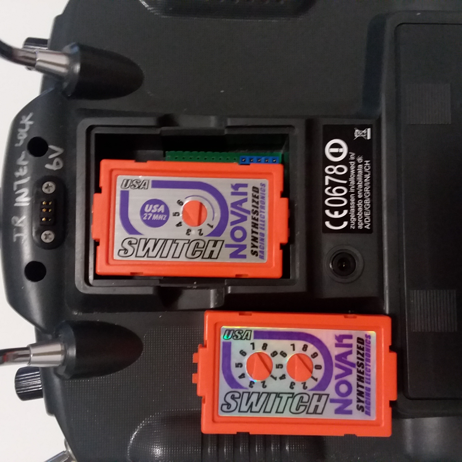

                    • cheapsub
                      • Feb 2011
                      • 200
                      Got the transmitter part. up to 16 channel.
                      But no solution for receiver yet.
