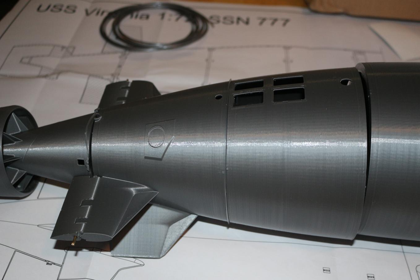

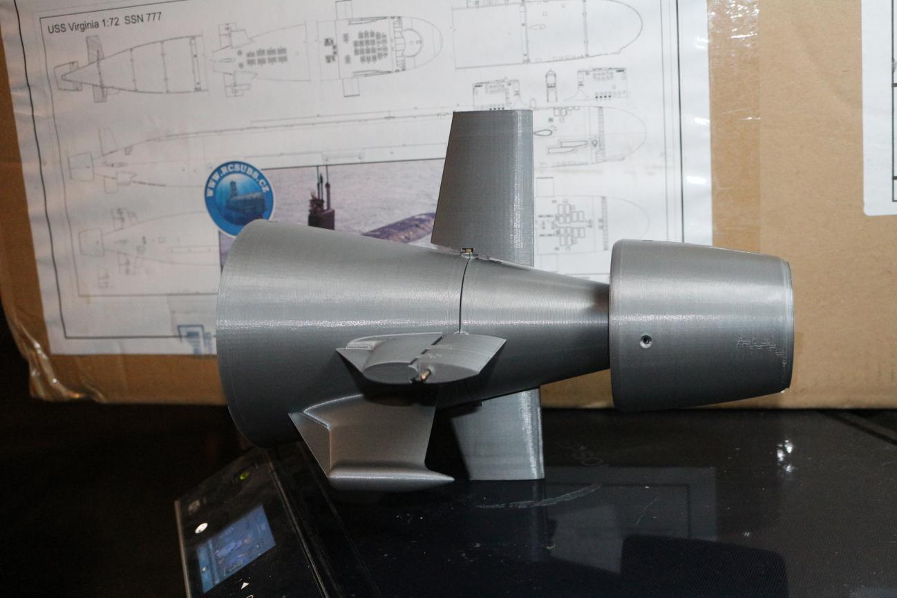

        Cylinder for a single prop Virginia class...
        Do you have any pics to further describe your cylinder? I am building my 1/72 Virginia-class USS ILLINOIS and am trying to figure out how to attach the cylinder to aft end of the boat and slide it into the main hull, maybe on some kind of rail to keep everything lined up. The kit I bought is 3d printed pla material and has a pvc central body with fore and aft hull parts with no way to get to the internals without cutting some kind of access hole or pulling one end off.
          As I get all the parts printed and assembled I'll post some photos. I'm just getting started.
