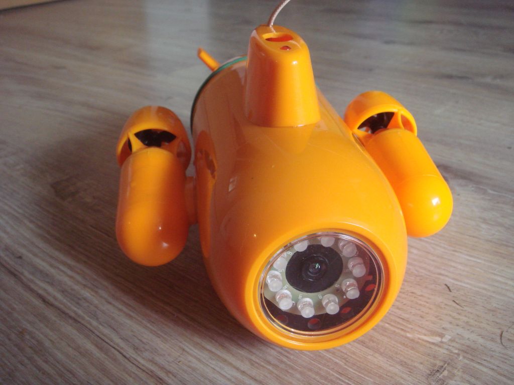

Some technical specs:
• Dynamic diving.
• Length: 256 mm (10 “).
• Mass: 800 g (28 oz).
• RC: 2,4 GHz (proportional).
• FPV video: 5,8 GHz.
• Front HD color camera (1280 x 1024).
• 10 white LEDs around camera (controlled by switch) for dusk / night operation.

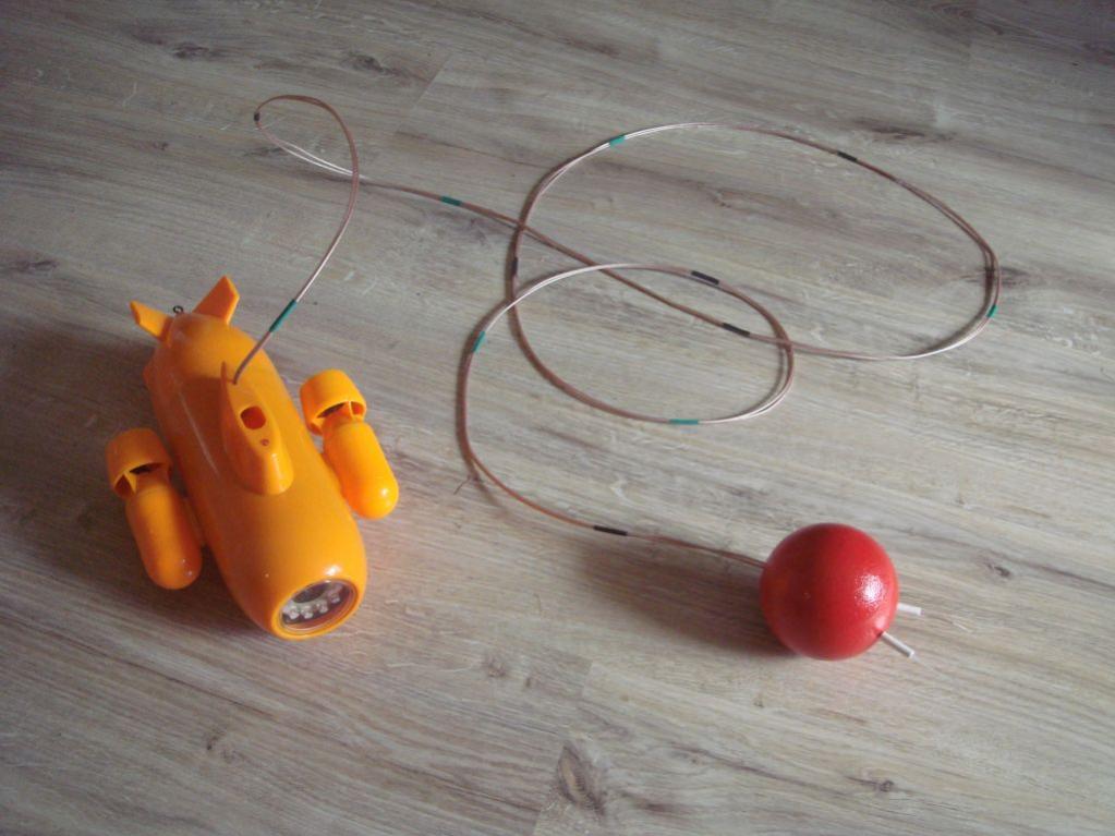

Cable length between sub and antenna float (max. operating depth): 3 m (appr. 10 ft).

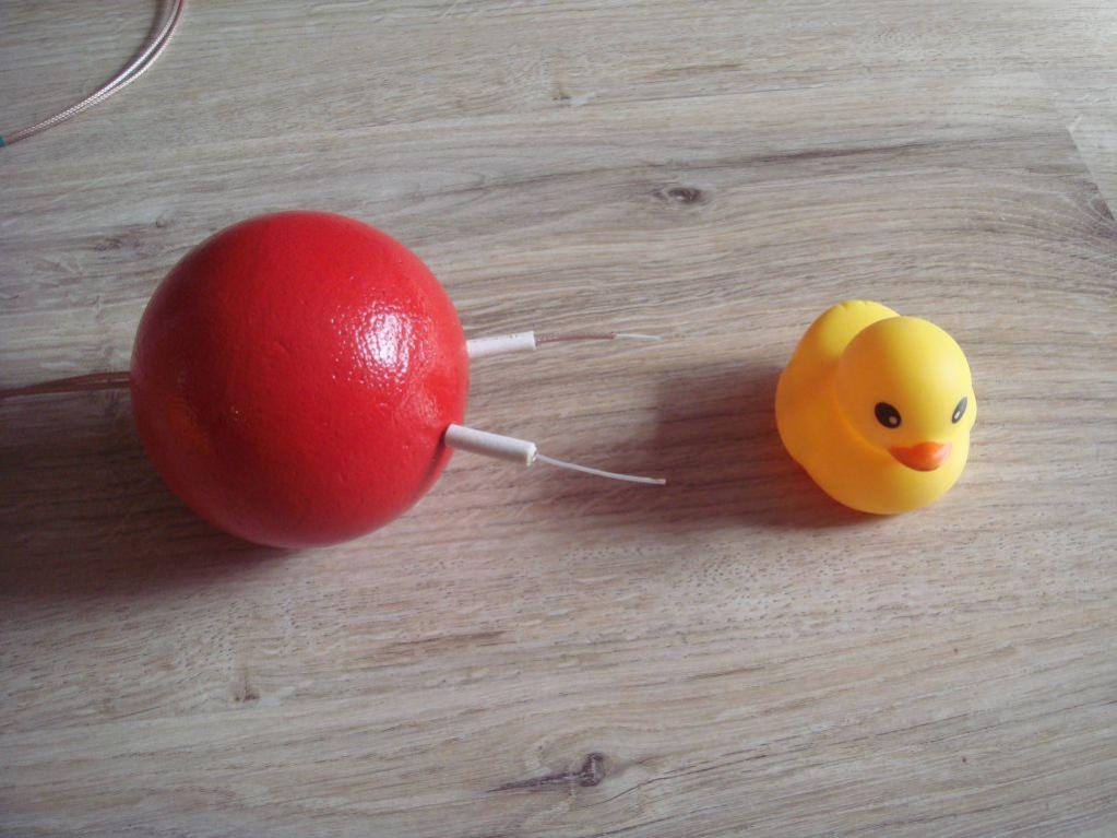

RC- and video signals received / transmitted via lambda/4 stub antennas (enough stuff for experiments, e.g. using circular polarized cloverleaf antennas to add some dB gain).
Original antenna float was a plastic duck; replaced by a styrofoam ball (I guess people would giggle, watching me at the lake while “running a small RC duck” ).
