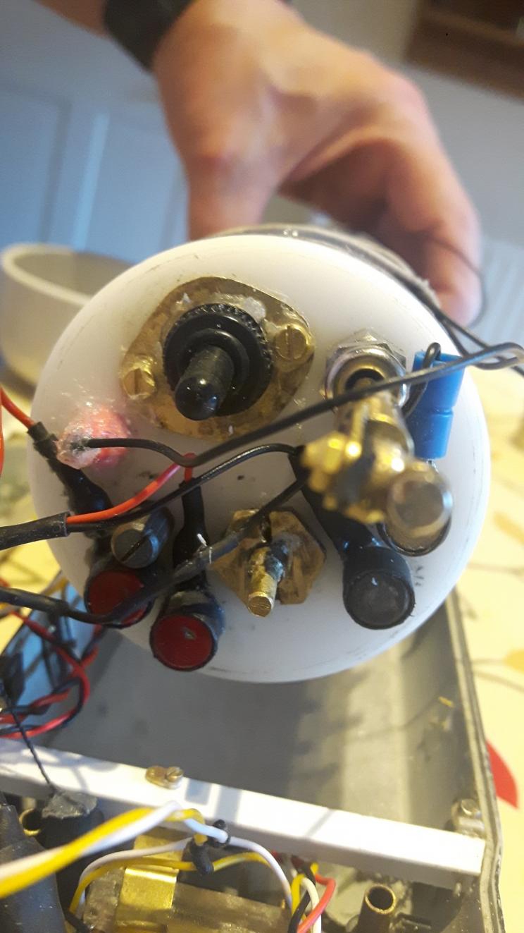

                  Hi Jeff, picture of the front attached
Name:	wtc front.jpg
                  The red button looking things are the brass screw caps respectively for the battery postive and the postive-switched circuit - for torpedo pump or cameras or whatever. the corresponding ones on the other side are battery negative and negative-switched connections, the latter of which is the negative terminal for every system on the boat. the slotted end things are the brass wtc retaining collars. These and the rods they are attached to are electrically isolated and carry no charge - last time I checked anyway. The hexagonal brass thing is just a stop to replace a schrader valve I had installed for leak testing - before it occurred to me that this design self-pressurises! Besides, it started to leak itself.

                    It's difficult to tell from the photo, but it appears that your battery terminals are exposed to water? That could cause some issues.
                    Also, for the external antenna....how did you waterproof the far end?
                      I agree with Jeff. There are several areas of concern.
                      There is heat-string tubing in several locations. I do not know if it is for bundling cables but there appears to be a couple where that is not the case. Those need to be sealed because water will get inside. Something that I do now is put a bit of silicon rubber on the wire at the location of a soldered area (making sure the solder is good) then slide some heat-shrink over it then let it set for a few moments, not long, then use a heat gun to shrink the tube. You should see silicon ooze out each side. I also do this at the end of my antenna. Did you modify or cut your antenna?
                      Your battery connections/terminals as Jeff mention need to be sealed too!
                      All of these will cause problems.

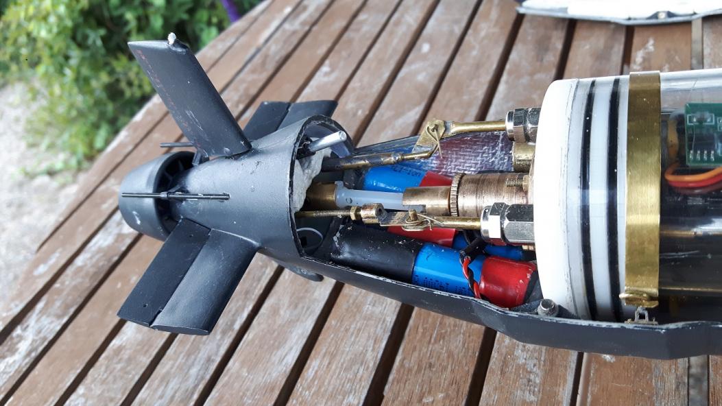

                        Hello again, managed to find some time to do a bit of experimenting. I got an FM radio and tuned it to 87 mhz - the closest you can get to 40Mhz on a conventional set here in the UK. Leaving the aerial fully retracted - I only wanted to pick up stuff close by - I passed this closely over the model while powered up.
                        There was a lot of noise generally but the noise from the after end, over the stabilizer, was extreme - sort of like morse code with a rythmic thrum in the background. This would explain the total loss of signal when I previously tried to move the boat's own aerial toward the aft. Interestingly the main power line - the one I close twisted with a drill - was actually very quiet. The worst offenders, after the stablizer, were the servo leads.
                        So, I covered the stabilizer with 'cling film' or sandwich wrap, then some aluminium foil and then another layer of cling film. This killed the noise totally.
                        Then I moved as much wiring as possible to the 'lower deck' - there was much too much near in the top half of the cylinder, then I reduced the remaining cable to as much as was practical and braided some servo leads.
                        The result is that my radio, a Futaba, F14, now works - with its aerial fully down (telescoped in) - out to about 33 feet or so, up from the nine or so feet previously. I think that is probably as good as I can hope for...
