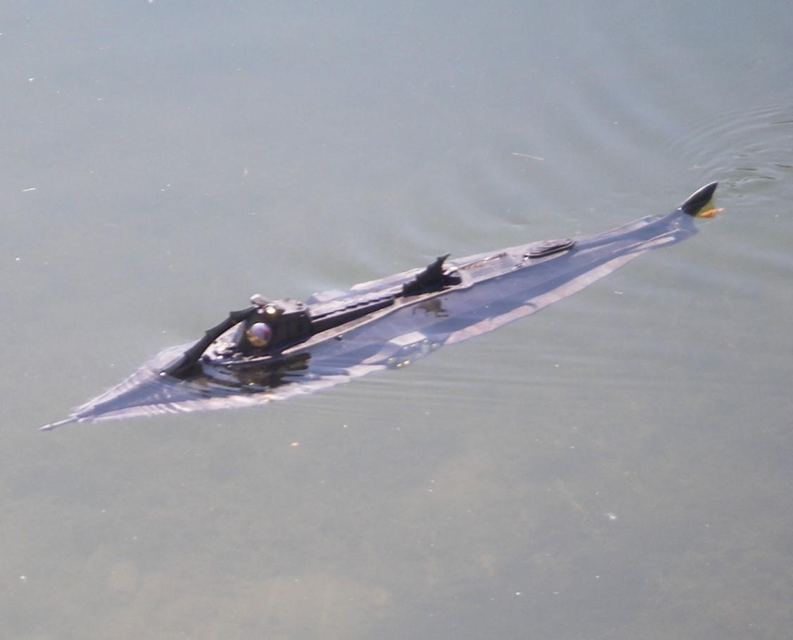

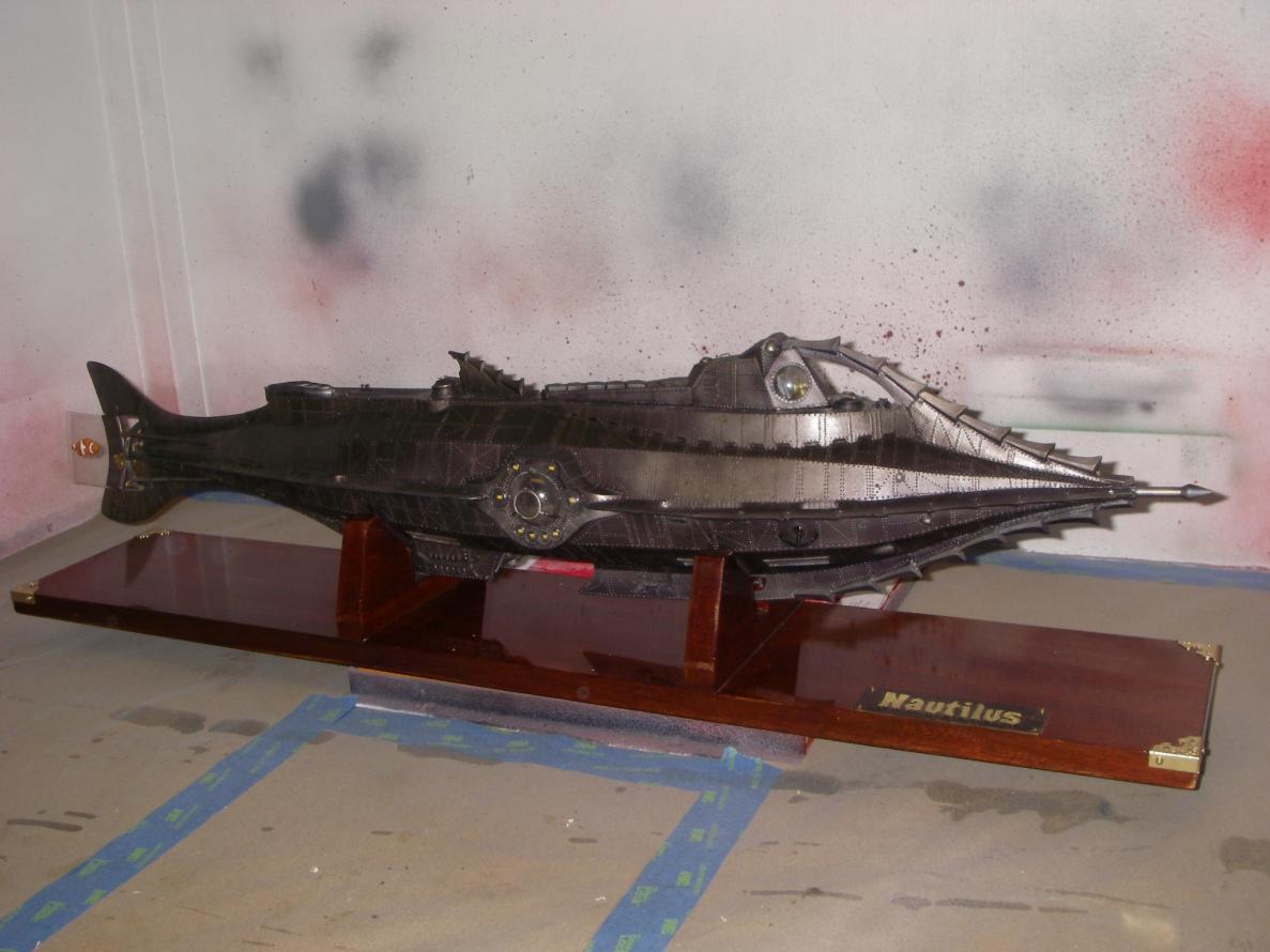

            I use a lot of Testor's Model Master Acryl paints, with a clear coat. On my Disney NUATILUS, I used several different colors of AlClad II lacquers: dull aluminum; steel; burnt iron; exhaust manifold; and pale burnt metal.
