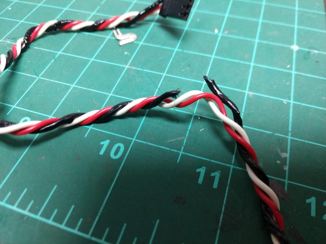

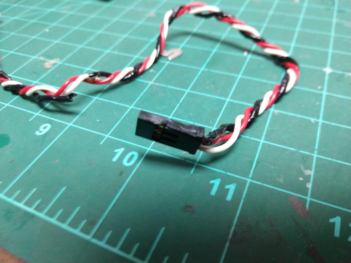

    BTW, after I yanked the old VOLCANO, I discovered the damage to the ground lead was much more extensive. It appears to have acted like a fuse. I didn't see this actual break till after it was out and suspect it was touching allowing the boat to run intermittently, appearing like the "Groton Glitch" we're familiar with. Pulling it out must've finally broke it apart. Notice the heat damage on the black wire......
    ...and on the connector itself.

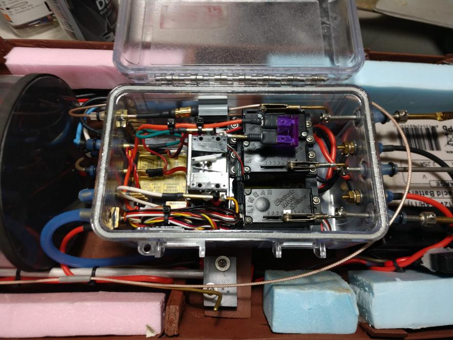

    Here's a photo of the current setup. A Fast Cruise (bench test) indicated everything appears fine. Hope to get her out this weekend and prove it.

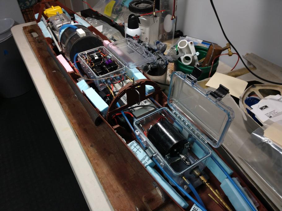

    As some of you remember, MOD2.0 utilized a home made PVC pipe with that annular ballast tank. Great idea for economizing on space, but my particular unit was difficult to service. This new system, which I'm finally settling on as the standard for 6 of my 8 boats has proven to remain BONE dry with access as easy as flipping two latches. Easy-peasy to stuff with operating gear. If fact 722 set up will be identical to 591.
