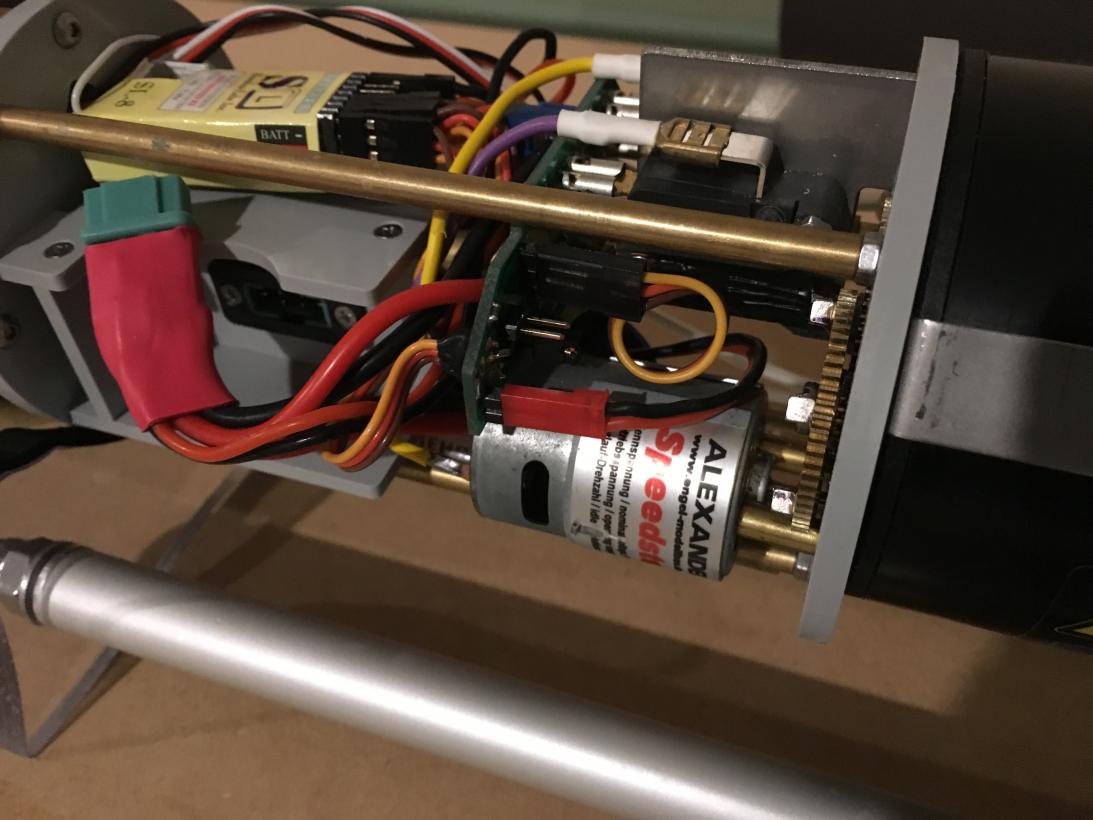

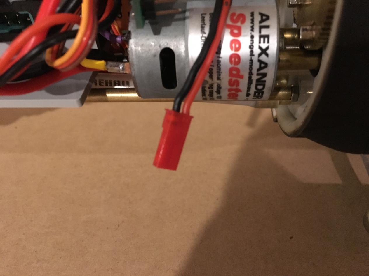

            Sanity check question about the board on the other side of the tech rack. Is this the CTS2 that is installed on the aft end of the piston tank? If yes, then (also) if your purchase included the wire and connector set for the Type 212 you should see a small two-wire connector with a thin red and black set of wires. Here's what mine looks like.....the first photo shows it connected to the CTS2 and the second shows it not connected:
