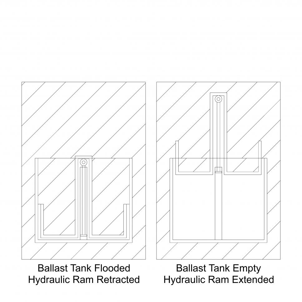

              This sketch is what I am thinking for actuating a piston ballast tank.
Name:	Hydraulic Ballast Actuate.jpg
