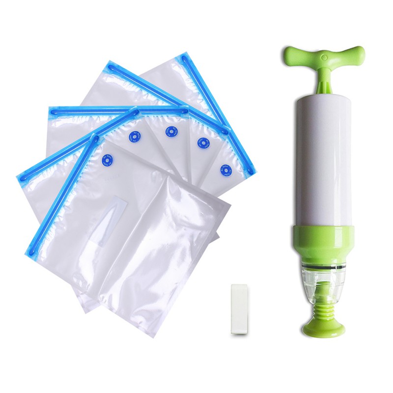

              How about making a dry box for the servo and mounting them like small work model servos?
              Tupperware sandwich box. Pill bottle. Otter box. Vacuum bag.
