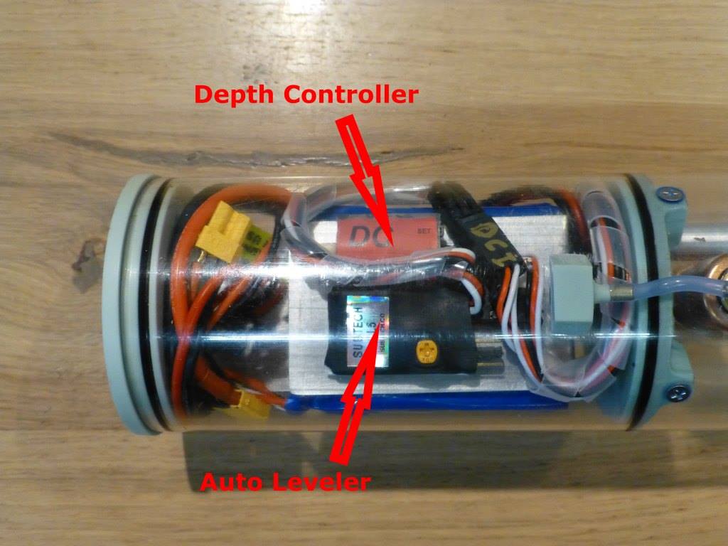

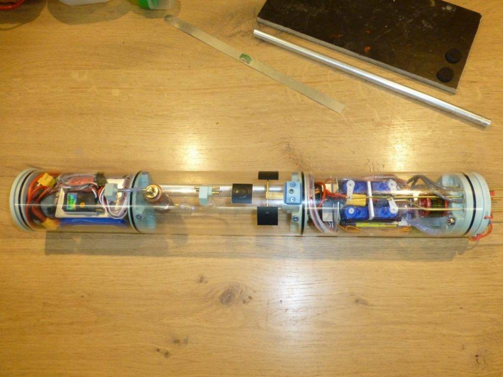

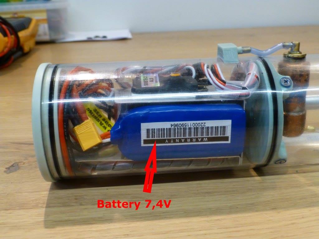

              I also have a 2.5" SD
              I have a 3600mAh 2s (7.4V) in the fwd compartment, and I have a lot of other stuff in there.

                              This is what I use:
                              3600mAh 2S 12C Lipo Receiver Pack
                              I have exchanged the brushless motor for a small brushless outrunner 3800kv motor. Brushless motors are more economical. I reduced the speed of the motor down to 50% else the refs of the output shaft are to high and will burn / wear down the seal of the prop shaft.
                              It is connected to a dia. 43mm 7 blade prop through the original gearing.
                              It propulse a 1/144 Akula dimensions approx. dia 80 x 800 mm
                              All the above together it results in a run time of more the 2 hours. I’m fat up before the battery is drained. Yeah I like the built process more than the actually sailing.
                              This works for me, I do not run my sub as a semi torpedo, I’m captain slow.
