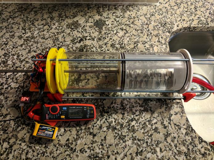

    Wanted to share some work I've been doing on a Piston Tank with 3D Printed Components.

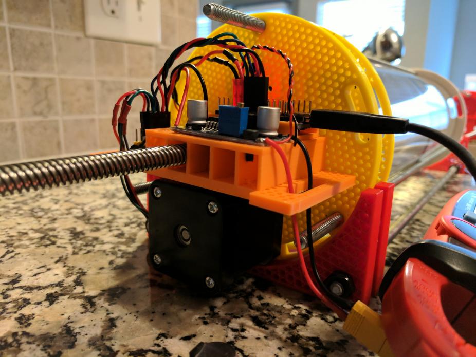

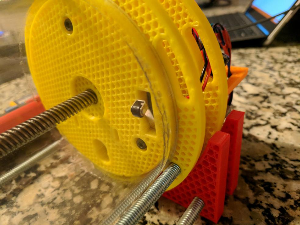

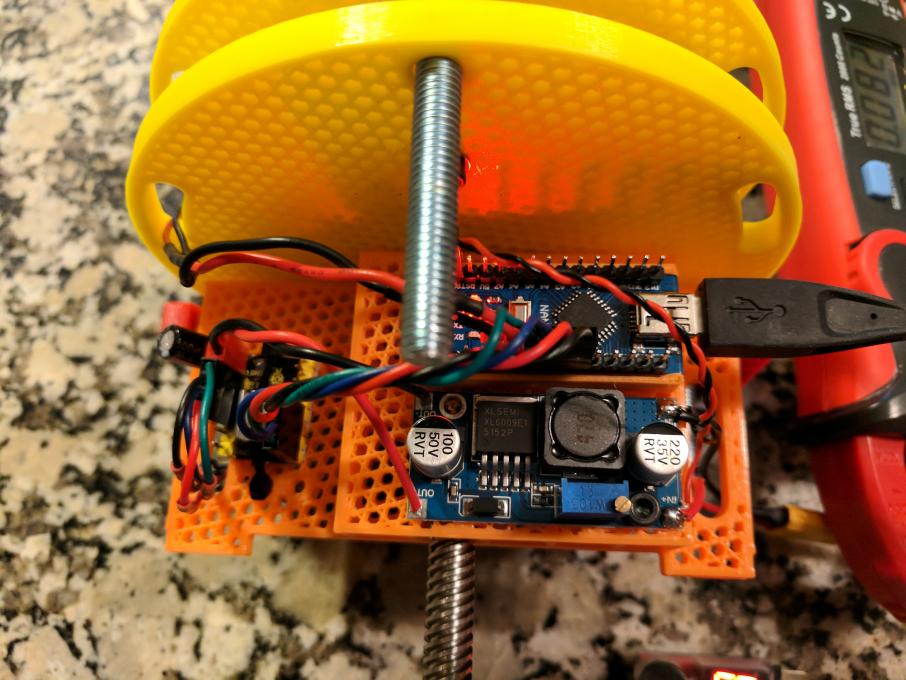

    Tank Caps, Cylinder Head, Gears and Mounts are all 3D Printed. Piston position is powered by a Open-Loop Stepper with 4:1 Gear Reduction controlled by an Arduino Nano. Takes about 30 seconds for the piston to move the full length of the tank.

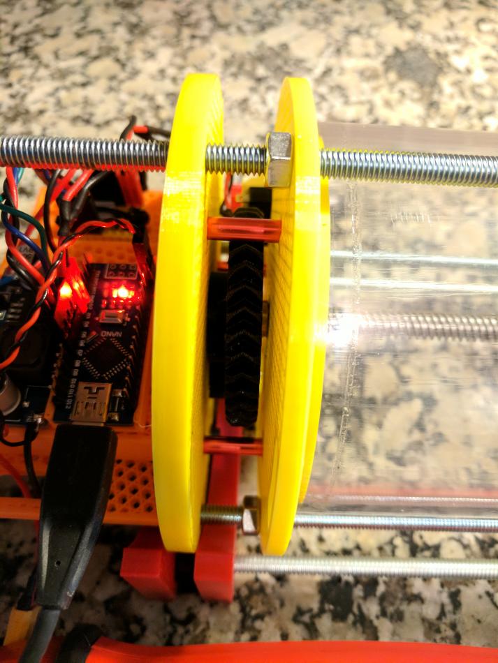

    Gears are Herringbone design to minimize axial forces.

      Yes, when power is first applied the piston homes and triggers a limit switch at the full position. Once this has finished it can then be moved to any position.

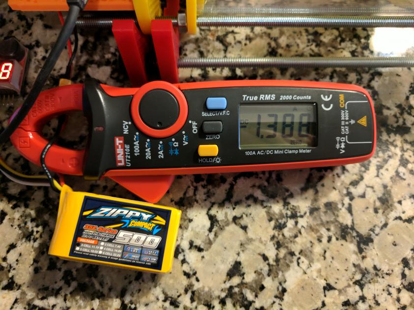

      Uses ~1.4Amps @ 12 Volts when in use, after movement is done the stepper driver is shutoff and only the Arduino needs power.
