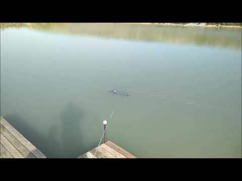

          Ok....no gyro on it today.....I can see that it will not work that great anyway :-)
          Ballasted the sub down even more, and it performs great.
          Still, my buddy is not a great subdriver yet, and I was filming :-)

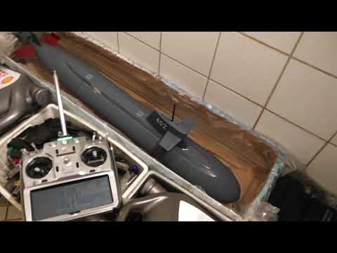

            Next phase...... Try to mess with static diving.
            Want to try the pump and bag system, as it seems simple.
            Got a waterpump, solonoide valve, and a bladder bag.
            No room for the lipo batts, i bought 10nimh 5000 cells instead. Good for ballast too.
            Never tried rhis before, so it will be a nice learning experiance.
            How much water ballast will I need do you guys estimate?
            My bladder is 600ml, but I guess that 300ml or half full will be enough? When on the surface, I want to see more of the submarine, than it is now.

                The way to find out how much ballast you need to trim the boat to submerged trim is best found via empirical means (you can get a rough idea by calculation, but it'll be off by a bit almost guaranteed).
                In a test tank, trim your boat with lead weight until only a few grams of buoyancy, then add a bit more to make it negative. Using blocks of styrene foam below the waterline, bring the boat to you intended waterline. Add up the volume of the blocks used, and that will be the size of tank you need.

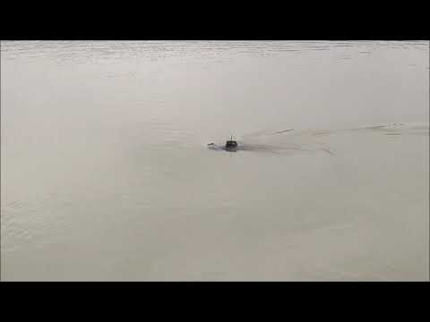

                      #40
                      Awesome...it works fantastic.
                      It was a little tail heavy at first, but I added a tiny amount of balast in the front, and then it was great
