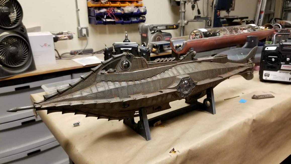

    Hello, everyone!
    While very possible, converting our beloved boat to functional vessel is not the easiest of tasks. She has some design characteristics that make such an endeavor a bit less than straightforward.
    Over the years, I've come up with what I feel is a great compromise between cosmetics and functionality, and I just completed a very in-depth tutorial on converting our 77th scale Nautilus to R/C operation from beginning to end.
    You can feel free to check them out on my YouTube channel under RCSubGuy, or check out the videos themselves by clicking on the links below:
    Chapter One
    Chapter Two
    Chapter Three
    Chapter Four
    Chapter Five
    I hope you enjoy! Note that most everything that you'll need can be sourced from your local hobby shop or from my site at the Nautilus Drydocks.
    Have a great day!
    Bob Martin
    RCSubGuy
