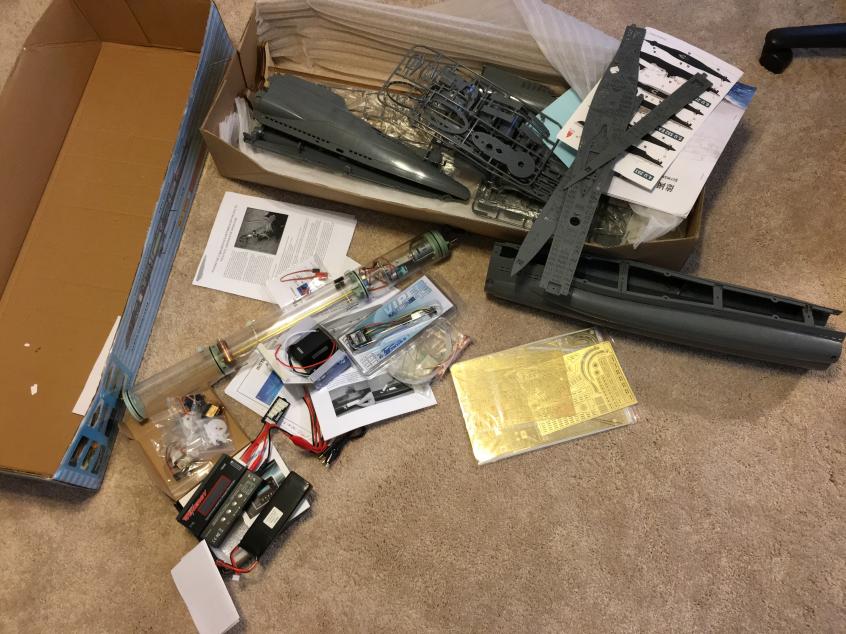

        Here's the pile. Still need a few things, but somewhere in this collection of parts is an R/C sub.
        I'll post pics of the photo etch set later.Click image for larger version

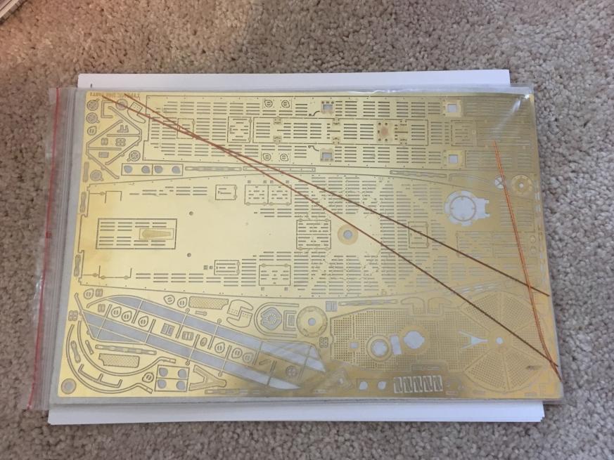

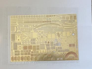

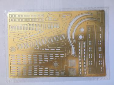

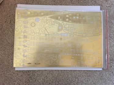

          Here's the 4 sheets of brass photo etch for this kit.
          I think this will add some pretty spectacular detail to the model.
          Note that you have to scavenge some of the plastic deck to use these pieces. So, it's all in with the photo etch; once you commit, there's no going back to the plastic.
