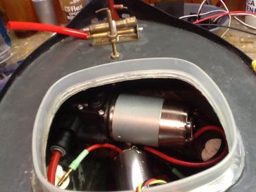

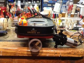

    But I can't leave well enough alone and have aquired a high pressure water pump and some carwash high pressure spray nozzles. And the high pressure plumbing to go with it.
    My plan it to try and fit all this into little Toot.
    My Washtech expert thinks I can get 20 plus feet of range with the fire monitor/water cannon. Lol
    The pump motor is larger than the drive motor.
    My eyeball says it will fit but time will tell. BDClick image for larger version

        My original pump and monitor would shoot 10' on a good day.
        I tried to install a Rule pump but it would not self prime.
        This new one is a Flow-Tech RV type pump.
        I have a 50/50 chance of getting it to work.
        But for me the fun is in the trying. BD

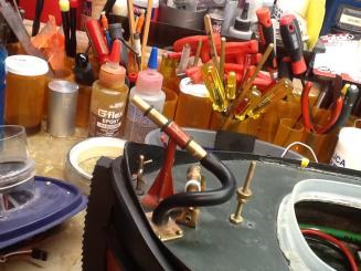

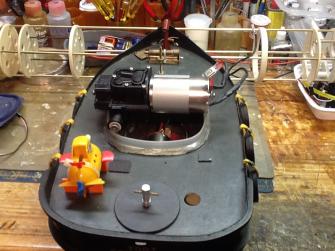

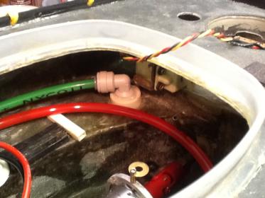

              I was able to get the pump and tubing inside.
              I have not tested the system yet in the boat as the RTV sealant is still setting up.
              I did test the pump out of the boat and it works great.
              The testing will be done with my original water cannon.
              I still have to make adapters to mount the new nozzles I aquired.
              The pump will actually sit a little further foreword.
              With the heavy weight of the pump in the bow I will most likely have to reballast the boat. BD
