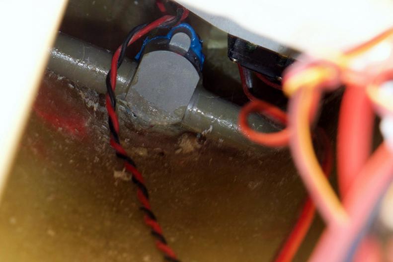

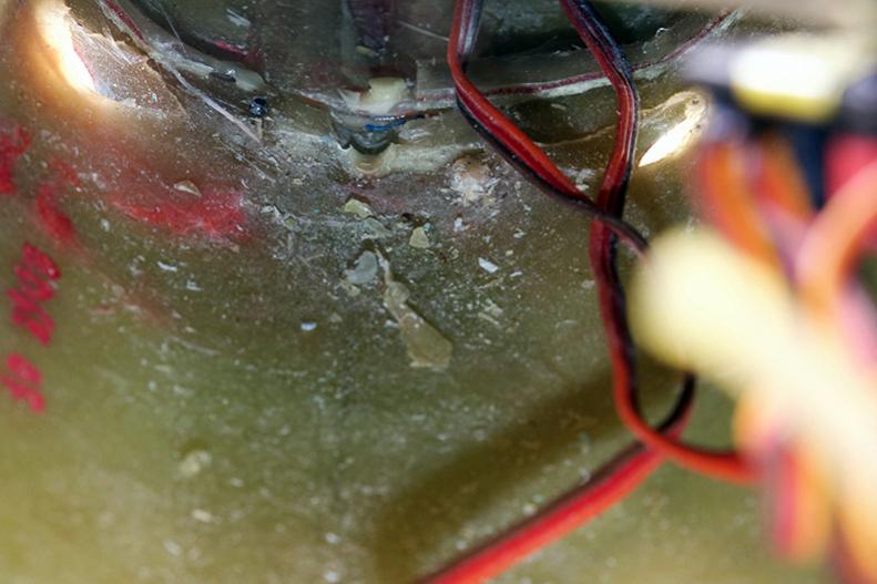

                        Bringing it back to the Akula, I braved the disassembly. This thing is engineered and the hands before me had done a pretty remarkable job on it.
                        It was not tough to free it up, it was tough working it out. That being said, success.
                        There is the bow thruster. A lot of air was coming out of both sides (and water in too). More than likely when it was shipped, some of the jostling around may have broken the seams around the openings at the bow. I remember Skip Assay talking about with forward motion that bow thrusters are useless for most subs, so out it must go (one less area to leak).

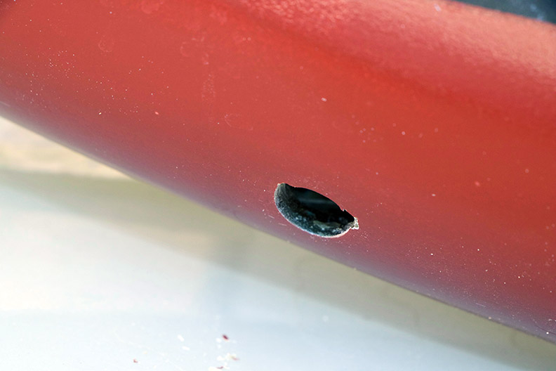

                        So, the damage was minimal and it came out pretty easy considering.
                        Now I need to apply some fiberglass on the inside. Suggestions?
                          Make a circular fiberglass cloth patch.
                          Radius of about 1/2" to 1" larger than the hole.
                          1/2" hole, I would use a 2.5" patch.
                          Clean the area where the patch will go on the inside of the hull.
                          If there is room, a dremel with a sanding drum or grinding disk.
                          Rough up the area to be patched.
                          Clean with alcohol after grinding.
                          Put masking tape on the outside over the hole to keep epoxy from getting on the outside of the hull.
                          Cut a large patch and a slight smaller patch that go over the hole.
                          Also cut two or three small patches that will fit in to the hole.
                          Time to get messy.
                          Mix a small amount of epoxy. (or what every the hull was made of)
                          Applying on the inside of hull, bush over the hole making sure to get in the hole and all of the sanded area. (you could tape of the inside area to limit the area to be covered.
                          Apply epoxy to the small cloth pieces to go inside the hole.
                          Then the large patch followed up by the smaller patch.
                          Apply and center over the hole.
                          Work it to remove any and all bubbles.
                          Place the hull with the hole down and centered/level so the epoxy does not run all over.
                          Let cure. (what ever the epoxy instructions say)
                          Remove the outside tape and then the inside tape if used.
                          After full cure, grind, fill or sand the outside of the hull to shape where the hole has been filled.
                          If needed you can add body filler to finish off the hole if it is still low.
                          I have filled holes using fiber glass cloth and CA glue.
                          Use small amounts to build up as CA glue can get rather hot and could crack the hull.
                          It all sounds complicated and time consuming.
                          This is probably a 15 minute job once you have all the materials.
                          I have also been using Gorilla Glue to fill holes in my end caps as I remove through hull control rod seal fittings or removing holes drilled in the wrong place.
                          It is tough stuff and if you trim it before it completely cures (17 hours or so) you can make the sanding a grinding part less.
                          I would use glass cloth on the inside of hull and forget the small hole fillers.
                          Now to hear from the experts on glass hole filling.
                            The only two things I would add to Ralph's advice are:
                            • use several layers of medium cloth for the large inside patch. Since the hull is the pressure vessel, you want to ensure that the patch holds, and
                            • once the cloth patches cure, use an epoxy + filler mixture to fill the outside hull. Those Engel hulls are nice and thick!
