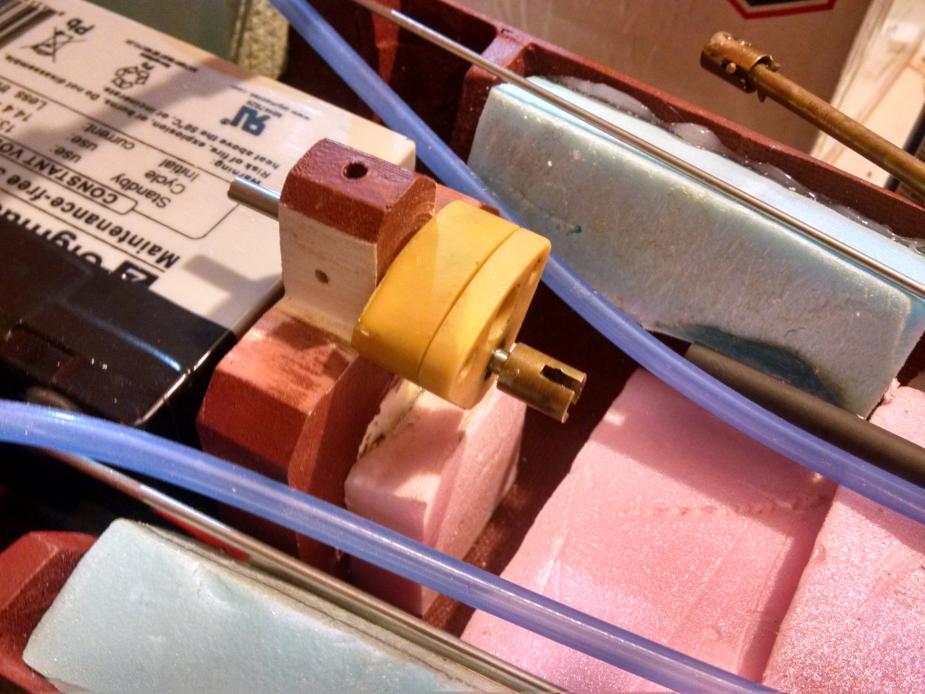

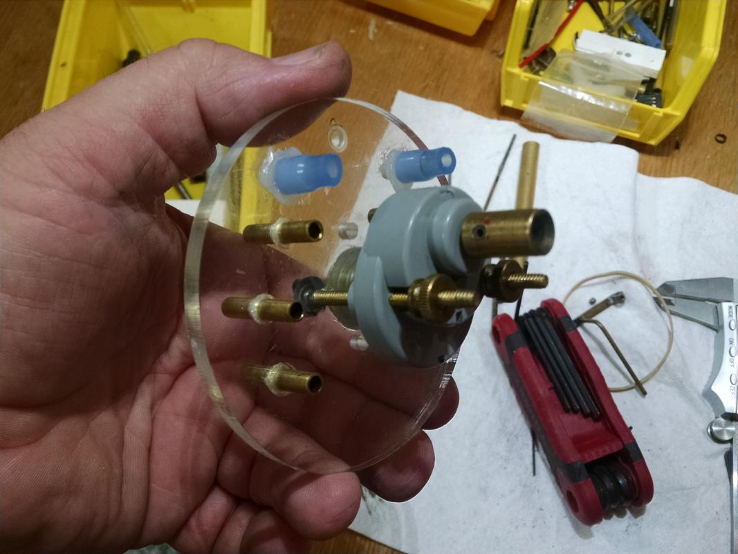

    Anyone recognize the 2nd gear reduction?? My SRP in action!
    First Gear Reduction unit on aft Bulkhead:

    2nd Gear Reduction unit on shaft support bulkhead.
Name:	2nd GR Unit.jpg

                p.s. that 2nd drive reduction looks like a Merriman set of parts?
                You win the Golden Ticket Jeff!!

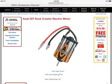

                          What you want is a motor like this.
                          High turn made for Rock Crawlers.
                          Great for direct drive in a sub. Lots of torque. BD
