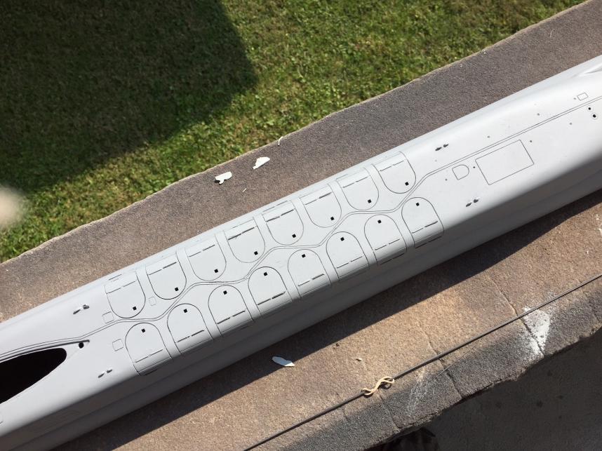

    Nine long years ago I purchased a Manley Lafayette boomer in 1/96 scale from the Sub Swap.
    Even though there is a slight length difference between the model and the correct length of the subject matter, I figured what the hell. I always told my brother-in-law I would eventually build a model of the Tecumseh, the boat he served as a machinist mate on during the early eighties.
    I sourced some good personal photo collections that showed certain details of the Tecumseh the would need to be added (most notably, a towed array). And there was a debate between he and I..... he swears there were no "hinges" on the missile doors. But I found more than a few photos that showed some sort of very subtle hinge-like arrangement protruding from the deck along each door. Using very thin piano wire, I added those 'hinges' to the deck. I also added the counter-measure tubes, angled the correct way. Scribed some of the Tecumseh's unique deck lines, and if memory serves I also had to change the location of the fairwater planes vertically along the sail.
    Then the boat got shelved. For nine long years it has sat, collecting dust. Today I salvaged her and she, or rather he, now sits a few feet away from me so that I can stare at it for long periods of time, plotting and planning my every move. After I return from Rochester, work will begin again in earnest. It's long past due that I do my brother-in-law proud.

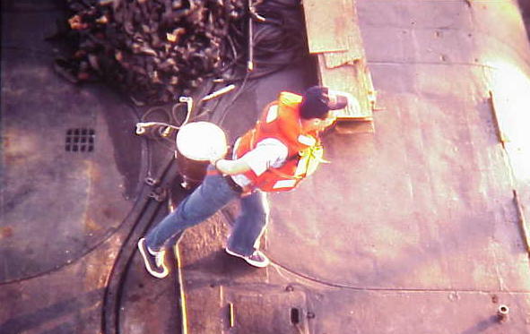

        Missile hatches. (older nuke boats)
        The hatch has a very large main hinge below the deck.
        There are two hinged deck covers that fold outward as the hatch opens.
        Requiring three hinges to allow the cover pieces to fold outward.
        I don't remember them sticking up.
        The hinges where flush with the deck.
        There was noting to trip over or snag rope.
        The slot was about 3/8" maybe 1/2" wide where the hinge was set in.

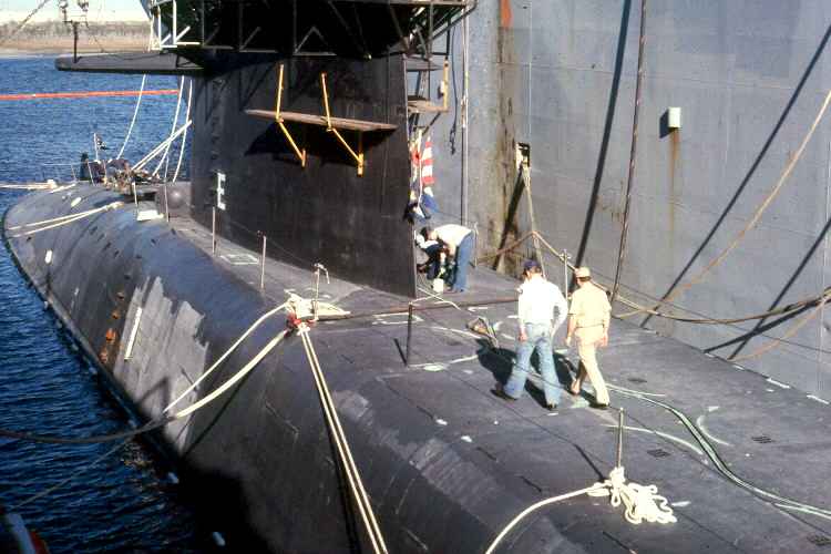

          Here's one example of what I'm talking about. On the top of the deck and again over the edge

            and another....

              one last one. my brother-in-law says the same thing, that the deck was smooth, but the more photos i dig up of the 628 the more of these i find

                Your photos definitely show the hinges, raised.
                Your representation looks good to me.
                Nice job on those.
                The hinges you see are the top and bottom of the two panels.
                There would be a hinge between the two panels but that hinges in under the panels.
                  There could be a million reasons as to why they are there like they are. I just thought it made for a unique detail on the model. Makes it stand out from the rest in a way.

                      Believe the pictures! I was on 631 and 634 and those hinges for the shell plating covers were indeed proud of the deck just about 3/4". They were way outboard so not many people noticed them. Being round in cross-section, there wasn't much that would snag on them and they weren't anywhere near the normal walking area. My uncle was leading cook on the Teacup back in the mid-to late 60's, I don't know which crew. At one time there were plans to make her the third Moored Training Ship at CHASN. I do work to support the two there now, 626 and 635. If you did hinges, you did good!

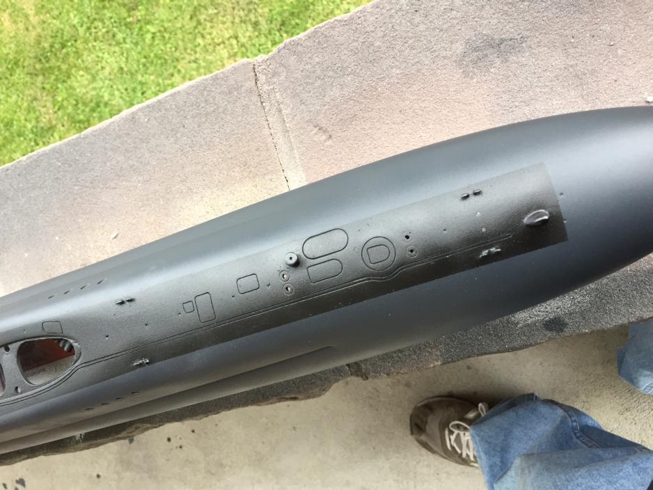

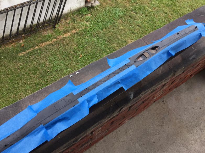

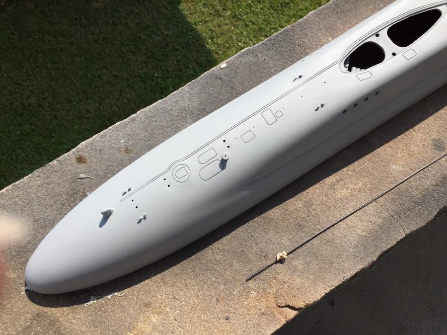

                          I'm at least at the point of parts of the hull being in primer gray. making some small progress. this whole getting married this weekend thing kinda messes with my free time

                              anti-skid on deck
