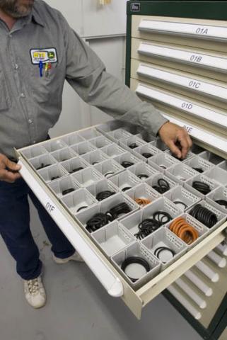

      The old o-rings are toast. What are "little draws"?
        Hardware stores have small draws with small parts in them.
        These parts are usually not packaged and are loose in draws.
        Specialty bolts, screws, washers, nylon bolts, brass fittings and such, including o-rings.

                  I use cup seal for 5/16". Mostly drive shafts.
                    Drawer
