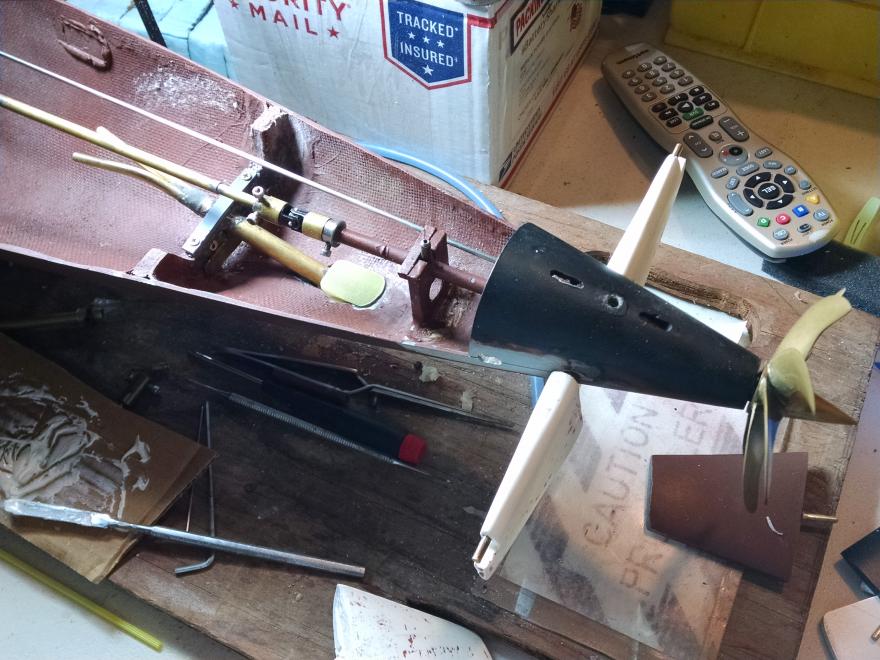

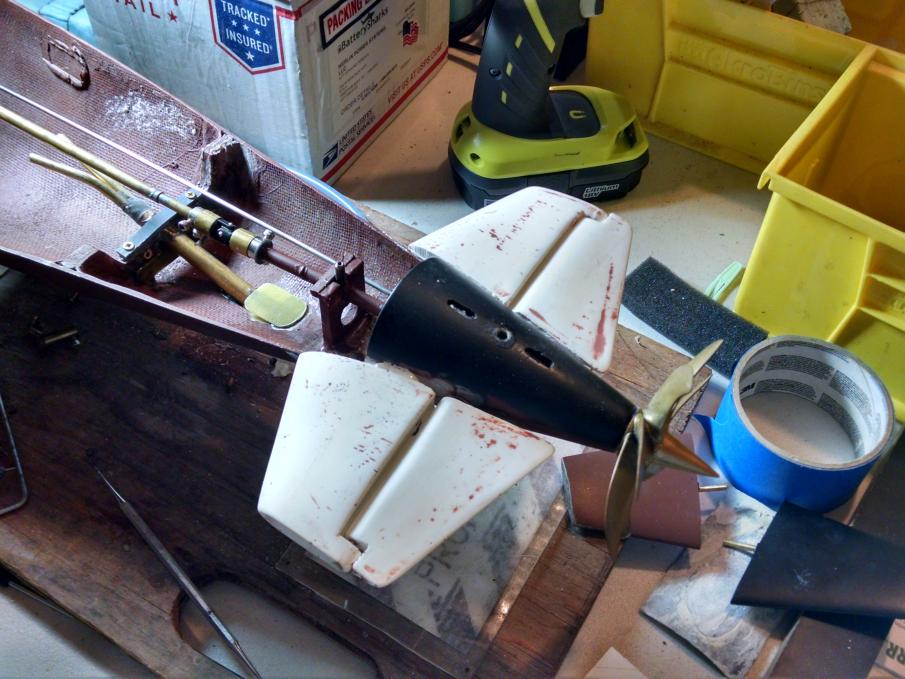

                SHARK update: 2016-08-16

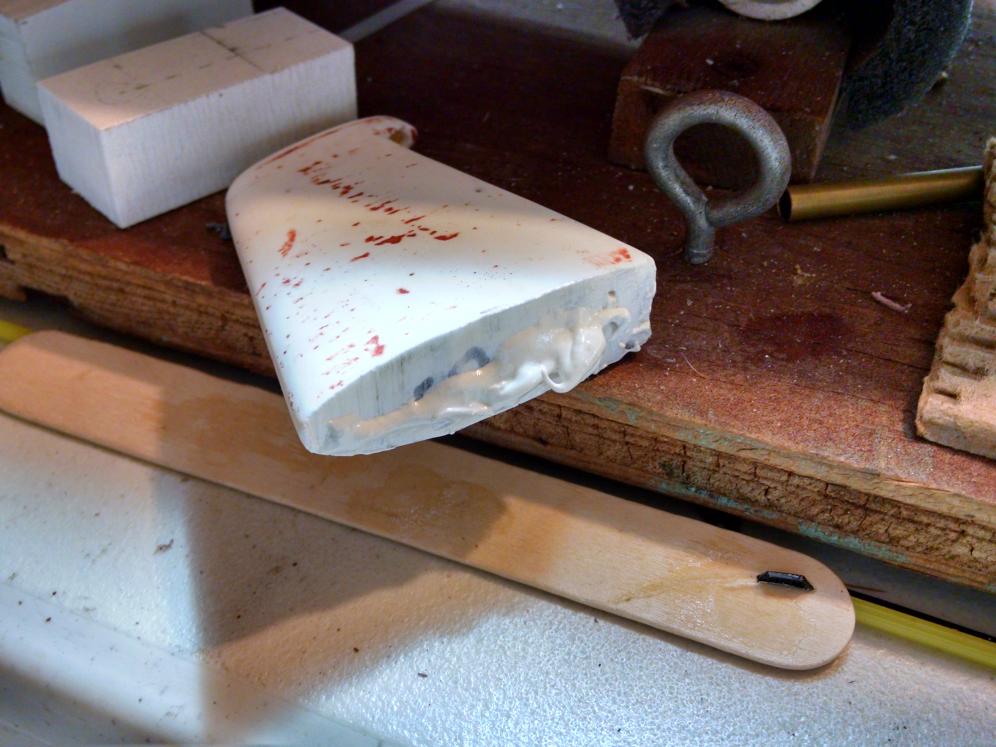

                Many thanks to Frederick Swendsen, (hereafter to be known as "The Swede" even though he's Norwegian like me so just sit back and enjoy the "Hell on Wheels" reference!) for offering up the newly cast two-piece stern planes to replace the out of character single piece that originally comes with the DeBoer kit. Not only does it give her a more accurate look, but hopefully she won't "porpoise" now on anything above a 2/3rd's bell due to hydrodynamic flutter on the planes.
                Looks like she'll be done this weekend! Trimming in Groton lol!!
                If the planes solve this control issue and I can open her up for real, I just may "land" a submerged speed record lol...not that that's the goal of course.

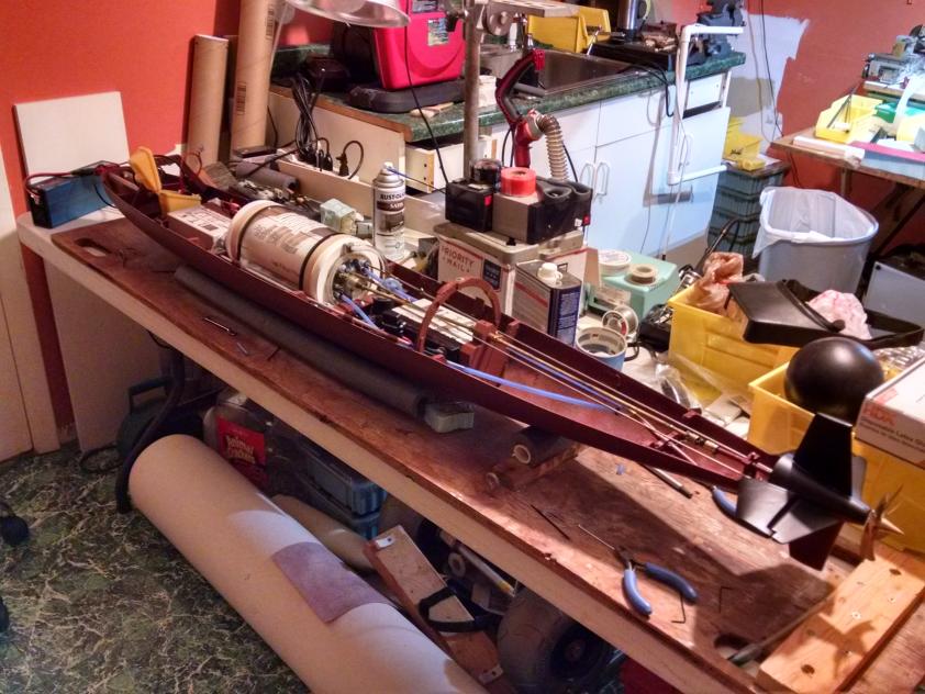

                        Well....since I'm committed to the 2.4Ghz for now, here the latest from last night.
                        SHARK update: 2016-08-31:

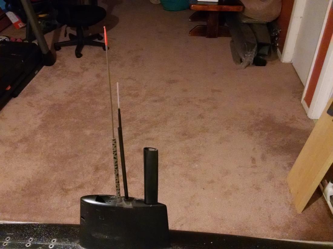

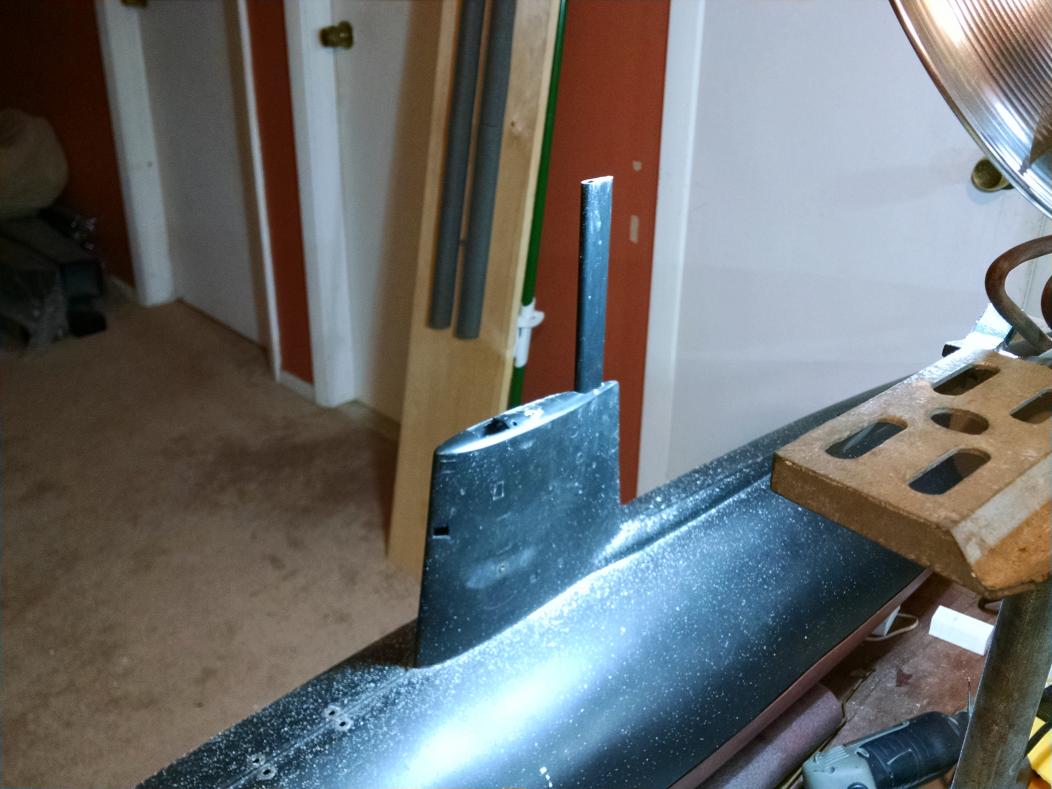

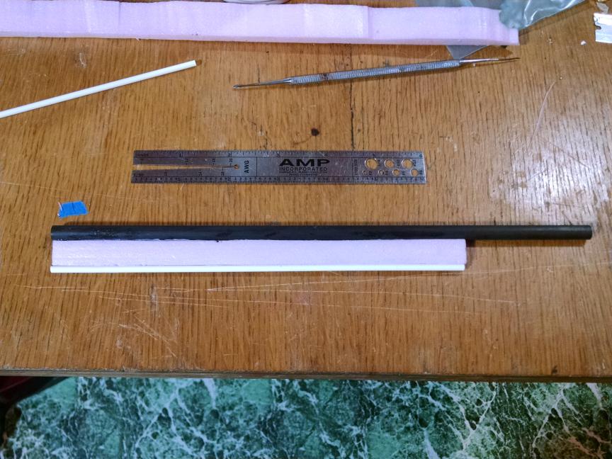

                        YES, these scopes and mast's are NOT to scale but it's what I have, and need, to run deeper than sail "awash" at times when the power boats "frak" with me. They sound like such angry hornets.....
                        The working Snorkel mast for air induction to surface will self raise and lower as the model surfaces or dive.
                        Not entirely committed to the look of the 2.4Ghz antenna, then again nothing else is scale.

                          Ed, not to gush over your scopes, but wow that is really a good modification! How are you managing to raise and lower your induction Snorkel?
                          I like this and look forward to seeing how it runs.
                            • 609

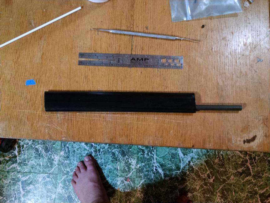

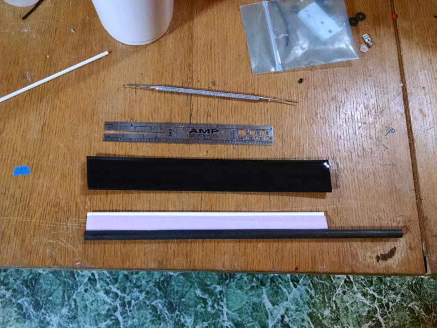

                            The short answer......, it's so light, it floats.
                            KISS principle. (Tattooed on my left tuchus check, the right is emblazoned with Murphy's law...sorry TMI)
                            Thin walled Carbon Fiber tube, close cell foam, and 1/8" OD PVC tube for support. Thin walled 3/4" Heat shrink tubing finishes it up.
                            This all slides over a brass tube inside the sail, which I hope it will ride up an down on. The tolerances are pretty loose.
                            Hopefully when she dives, it comes up, when it surface it goes back in. All thanks to the very water she floats in.
                            Never tried it before, so we'll see soon. My only concern is that too great a vacuum is generated as the water is drawn from the MBT, causing the mast to lower.
                            I do have gas backup.
                            Hopefully I'll be able to find the right balance between the suction and the inherent buoyancy of the mast.
                            SCIENCE!
