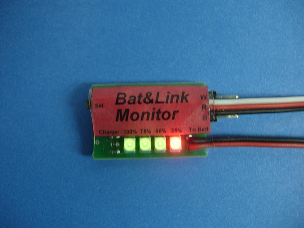

          Jump!
          Sounds like you're referring to a device like my "Battery and Link Monitor" (or BLM).
          BLM monitors the voltage on your battery and will blow your ballast tank dry once you reach the low-voltage cutoff level. It won't leave you stranded anywhere, but it will prevent you from flooding the tank again; Forced to the surface there's no mistaking that it's time to come home for a recharge. It currently supports 2S/3S LiPo, 5 cell to 8 cell NiCd/NiMh, and 6V/12V Lead Acid battery types. I have room to add more if there's a need in the future.
          Battery charge level is always visible on the 4-LED display, as is a running count of the number of missing frames that have occurred in the current run. (I've learned a lot about good radio-bay placement because of that.)
          Finally, as Tom mentioned it also acts as a fully programmable multi-stage failsafe device.

            Where can we buy this amazing device?

              BLMs can be ordered from me or through the SubDriver website. Please PM me if you've got any questions about it.
