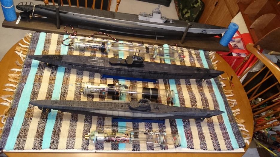

                            Here's the 3 subs together with the drivers for them. For dynamically diving, even the 2" motor section of the Type Video would work in all three subs. The gato will take a 3" cylinder but I don't see it working in the Type IX. The above water displacement of the Gato is twice the Type IX and you see the ballast tank is twice as long.
                              One other thing to consider is your radio system.
                              You really should have a radio that has multi model programming.
                              If not the set up going from one boat to another is a PITA.
                              Also keeping the boats the cylinder is going into about the same size would make life a whole lot easier as well. BD
