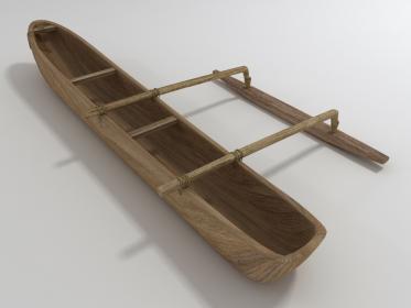

                        I have the canoe working and it floats but it is two top heavy and narrow to stay upright.
                        Wants to turn turtle.
                        It has been suggested I add outriggers to keep it upright.
                        I was thinking like they do with the dugout type canoes.
                        It's only a test for me but I would like to get some footage of the canoe paddling along.
                        BD
                          Like this.

                            What about adding a fin keel underneath?
                              Sadly it would be too heavy with that much extra weight. BD
