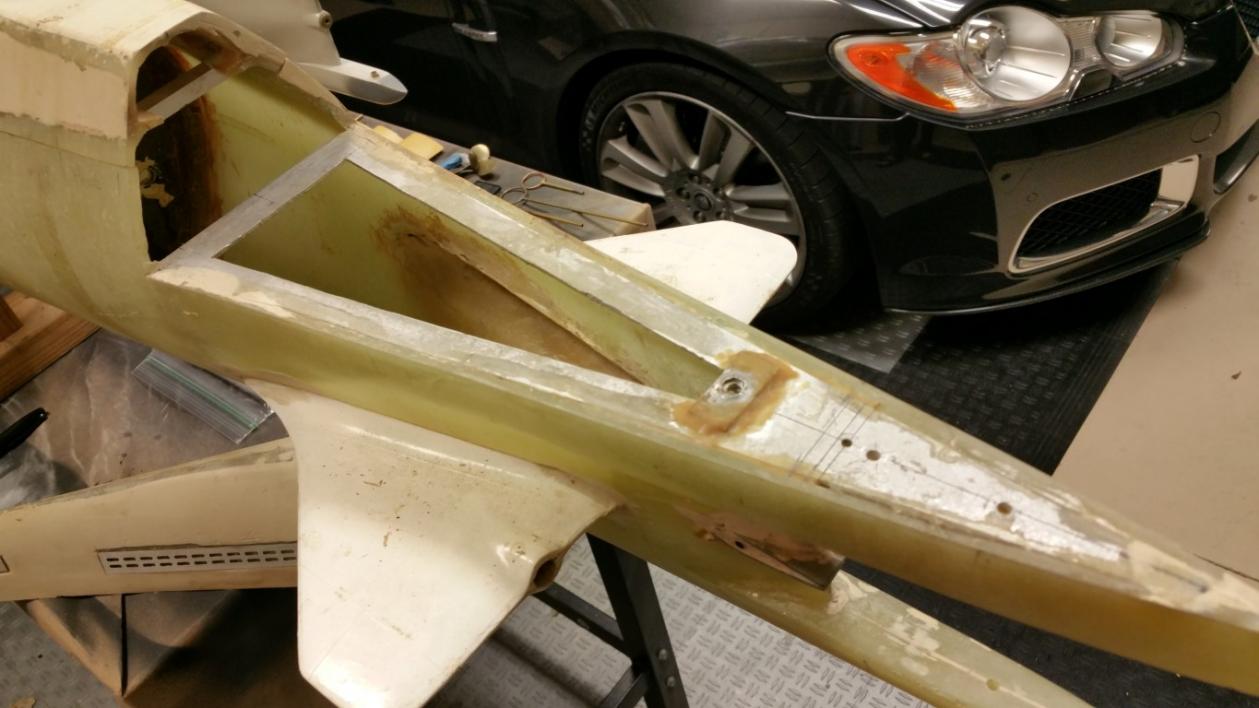

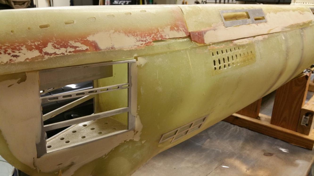

    Not a common subject to begin with, this particular boat also stood apart based on its size. Nearly 9ft long, this boat was a beast! In accurate measurements, it came in at 101.25" in length, or 257cm, putting it at right around 1/30th scale (or close enough to 1/32 scale that those parts should fit just fine). The hull was made from thick fiberglass with aluminum reinforcement at critical areas. The previous owner had gotten aluminum sheeting CNC cut to address many of the floodholes for a very precise finish. The hull weighed in at around 25lbs itself and was exceptionally rigid.

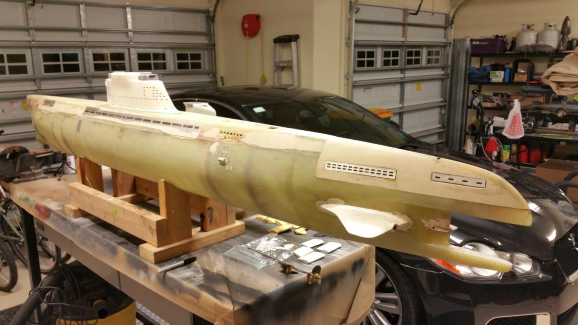

    Last night, I'm very happy to say it found its way to my shop and I got the chance to take a good look at it.
    Wow.
    Big is an understatement, and I don't know that the attached pic does it justice. I'm a big guy at 74" tall, and this boat still looks big next to me. The hull is between 3/16" and 1/4" thick throughout and is solid enough to cause serious damage if it hit an object while under full steam, I'd warrant. The CNC inserts are very well done and for the most part are installed nicely flush with the hull.
    The boat is set up as a dry hull but shouldn't pose too much of an issue to convert to accepting a large diameter cylinder. The upper deck opening ranges from 4" at the ends to 7" in the center of the boat. A 5" cylinder should be easy to install with room to spare.

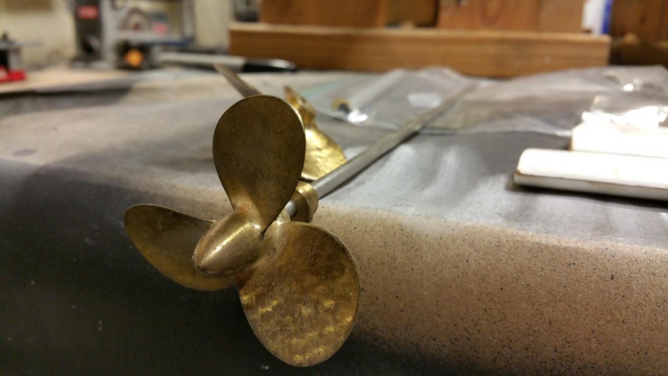

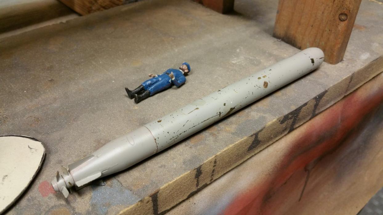

    There were quite a few extras such as beautiful scale brass props, masts, antennas and even a scale metal torpedo included with the deal as well.
