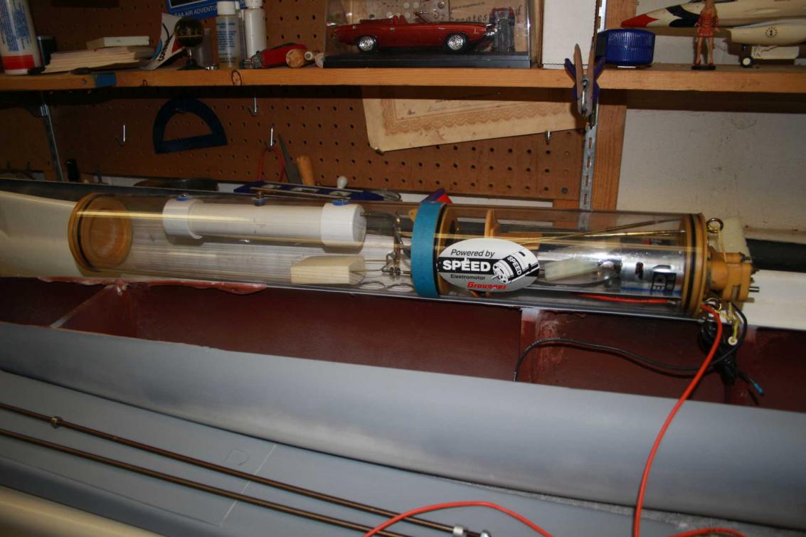

    I was going to replace the pvc tank in this early Merriman wtc with a copper one and use CO2 to raise this big boat. Any thoughts?

    Not sure if this is what you meant, but just in case......Going with CO2 will require a proper DOT-approved holding container....you don't want to build your own copper tank using the usual plumbing parts! The pressures involved with CO2 are far higher than the Propel that we use in the typical gas ballast system. You don't want to create something that will blow up in your face.
      Information.......
      At room temperature .........
      CO2 in cartridge is at 800 to 850 psi in a compressed gas state.
      Canned Air or Propel is at 71 psi in a liquid/gas state.
      In the late 80s I remember seeing boats destroyed and a few injuries do to CO2 system failures.
      I can not think of a Propel failure though I would think they have happened do construction of retention containers or poor plumbing.
      I just can't recall any.
        You will not be using a copper tank for CO2, that is only good for Propel systems. The CO2 systems use the 12 gr (http://www.walmart.com/ip/Crosman-12...-15ct/16662954) or 90 gr (http://www.pyramydair.com/s/a/Air_Ve...osable_2pk/336) cartridges. Mikesubworks used to have the complete system, but I think most people have stayed away because of the extreme pressure already expressed.
        So do not make this harder on yourself, go propel first. After awhile you can "upgrade" or better term modify your wtc for CO2.

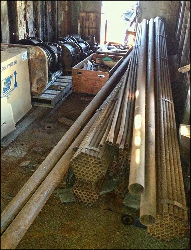

          800+psi is high grade stainless steel range with a pretty beefy flow regulator. I'd listen to these guys. In the event of a malfunction you'd have a pipe bomb, a rocket, or both and copper isn't used for high pressure because it's just too soft. To kind of put this into perspective, this is a photo of the superheater pipes for the SP&S 700, and she's only rated to 260psi. The other pipes are for the flue.

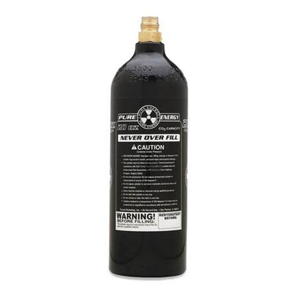

              Are these bottles tested for pressure?

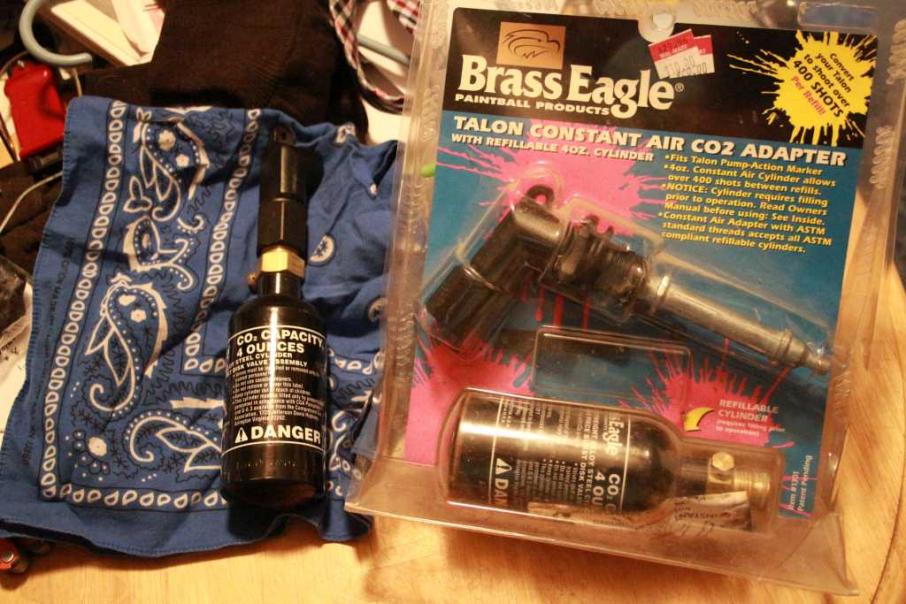

              Found these at a local farm store for co2 powered paintball guns. They come in various sizes. Are these tested and safe to use as storage tanks for co2? I've never done any paint ball stuff, so hopefully someone can advise me on their use.
              Also, these were given to me as a gift when I expressed an interest in using co2 in my sub-are these safe to use with the proper regulators?
              Thanks
              Dave
                Those CO2 containers look like they should be okay. If they are you should be able to see DOT markings on them......
                  If you have no experience with Co2, stay away from it!!! It has tremendous amounts stored energy and should be used only by qualified, experienced individuals. You are not just storing gas, you are storing liquid and vapor. If not handled with great care and knowledge you can suffer extreme injury and even death. There are much safer alternatives for operating large boats. There is a reason why these systems are a rarity. Ask Gene Berger.

                        I also have a Co2 system in my Ray Mason Nautilus. I have the system Mike's Subworks sold.
                        I used a 4 OZ paintball gas cylinder.
                        It was/is a great operating system. But sadly I have not had the sub out of its case in 6 years.
                        It was getting hard to get my Co2 bottle filled. Plus your bottles have to be up to date on pressure testing.
                        Jim Butt fills his own but I am not that brave.

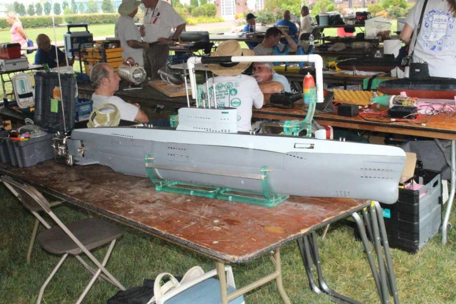

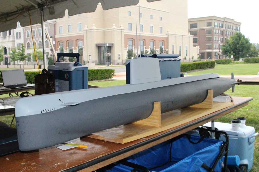

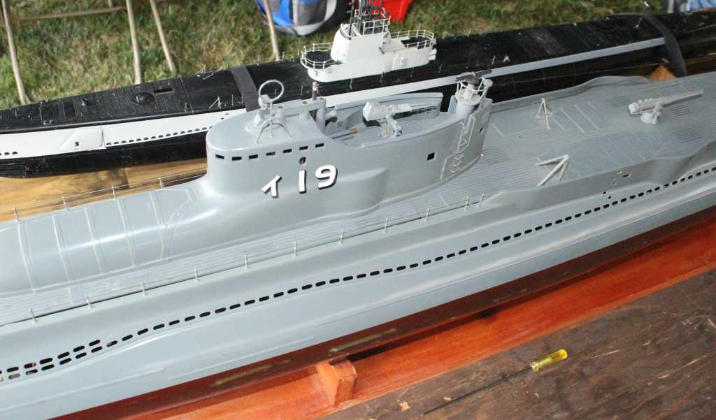

                          So, you would add a pump to the water tank and use a Propel tank for emergencies? Using just a pump, what kind of scale depth control would take place on a 6-7' sub, weighing approximately 25#? These boats were at the Carmel meet this year and are probably in the same size as mine will be-would a pump do a good job getting them up?
