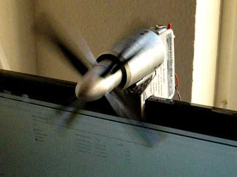

    Not a torpedo but an 1/33 counter rotating aircraft enginge made from Card.

      One more picClick image for larger version
        #48
        You mean contra-rotating props like this one?
        It's .875 inches in diameter and about 11.0 inches LOA.
