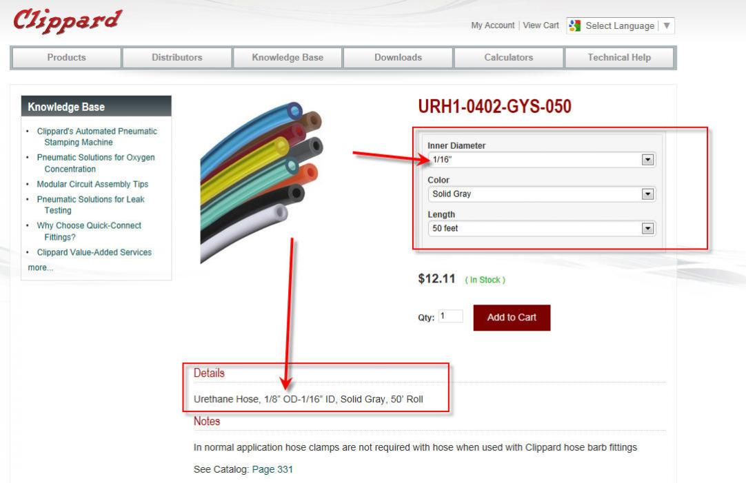

              Great feedback. Thank you all. And while we're at it talking about "gas pressure safety hose" - Is this the hose size you would get Clippard as a back up supply? Just making sure it is the rigth size.Thanks.

                  That looks like the gray hose that came in my WTC-3.
