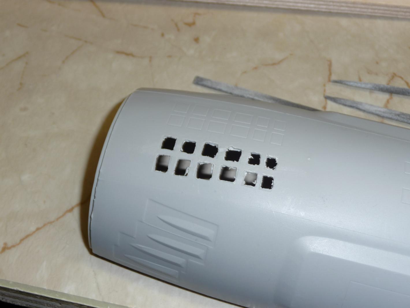

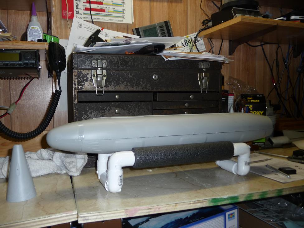

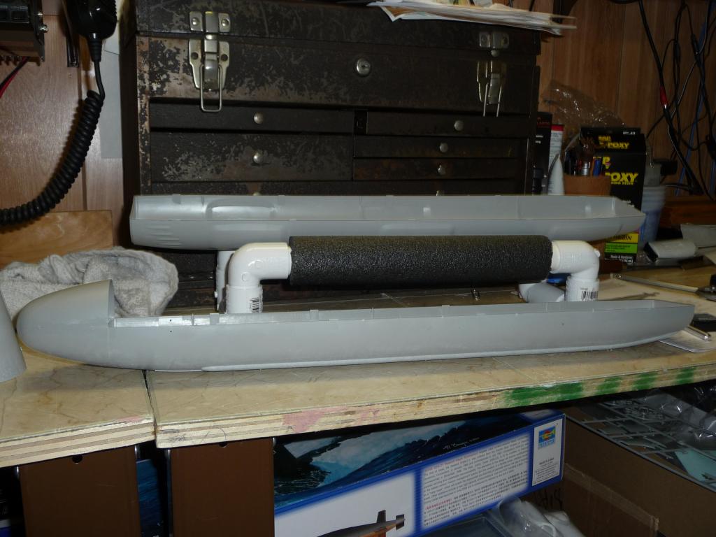

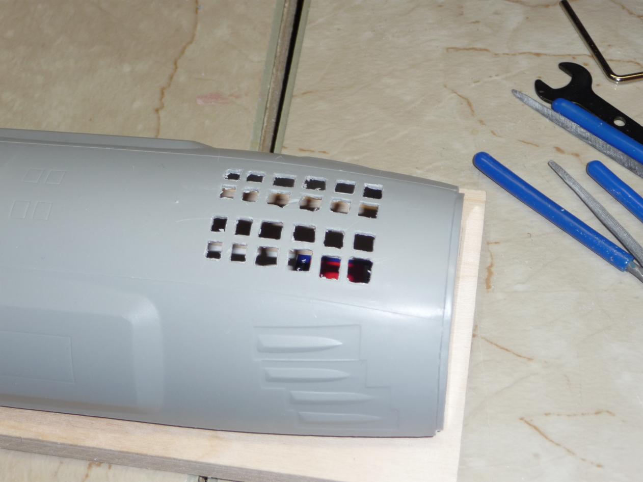

    Have started the build. Cutting flood holes and fitting the hull together.Click image for larger version

      Nice start. What have you learned from cutting out the flood holes?
      • Radioman
        • Jul 2015
        • 9
        Salmon
        They are a pain to cut out and file. Trying to cut them to the outlines. This is a first for me building a sub. Have built other ships.
          I am watching your progress.
          Flood holes.
          They can be a pain to do.
          What I learned many years ago, was to make wooden blocks that are cut to the size of the finished hole.
          They are slightly tapered so they will fit in a under sized hole and then I can slowly file the hole bigger and the wooden block will go deeper in tothe flood hole until it is the correct size.
          If I should over file the hole, I can put wax on the wooden block and use it to put body putty to fill the over sized hole to the right size.
          And here a couple of blocks are in the hull.
          The small flood hole in the back is not yet to correct size.
          Just a little more filing was needed.
          I think this makes cutting in and sizing floods a little faster with fewer redo(s).
