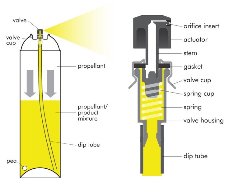

    Recently, I have come across several articles about not shaking your can of paint because it creates bubbles......
    Here is one article that says that:
    In the past 50 years (I am older than 50), this is new to me......I try not to be a stubborn old guy, but I need your thoughts and wisdom. Is this something new? What do the bubbles do?

                      Thank you! I've got sculpture experience myself, so I'll be happy to weigh in. Swirling versus shaking comes down to preference, mostly—shaking can definitely introduce bubbles when done aggressively, so swirling is a "safer" bet, albeit a process that takes a little longer. Swirling also has the benefit of listening for that pea as a good measure that the solution is totally mixed-in, while shaking will just cause the pea to rattle around.
