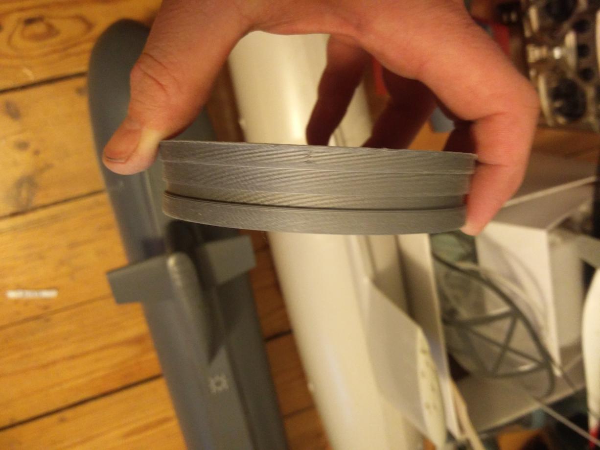

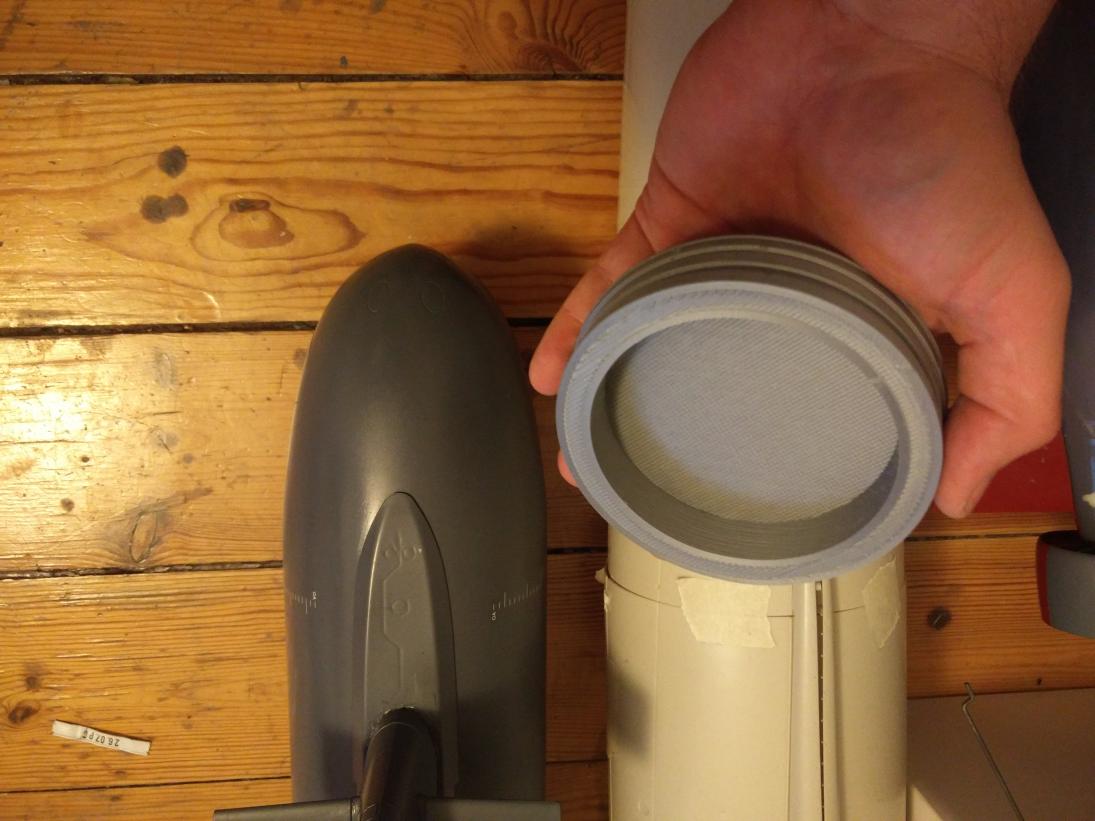

    I would like to try make my own WTC
    I have a PVC pipe with 100mm inner diameter, and I want to try to use 3d printed endcaps.
    I tried to design something in freecad in 3d for my printer for the first time, and I think endcaps is the perfect subject to practice on, as they are fairly simple....still a steep learing curve when starting from scratch :-)
    The test turned out fine.
    But.....what size O-rings should I buy for a my 100mm inner diameter tube ? And how thik do they need to be ?
    And how deep should I make the groove in the WTC cap assuming it is also a perfect fit at 100mm outer diameter ?
    Should I use 2 o-rings pr. endcap ?
    I want to try the ater pump and bladder system, which will increase pressure in the whole WTC when taiking in water.
    Can I use Viton O-rings , or only silicone ?

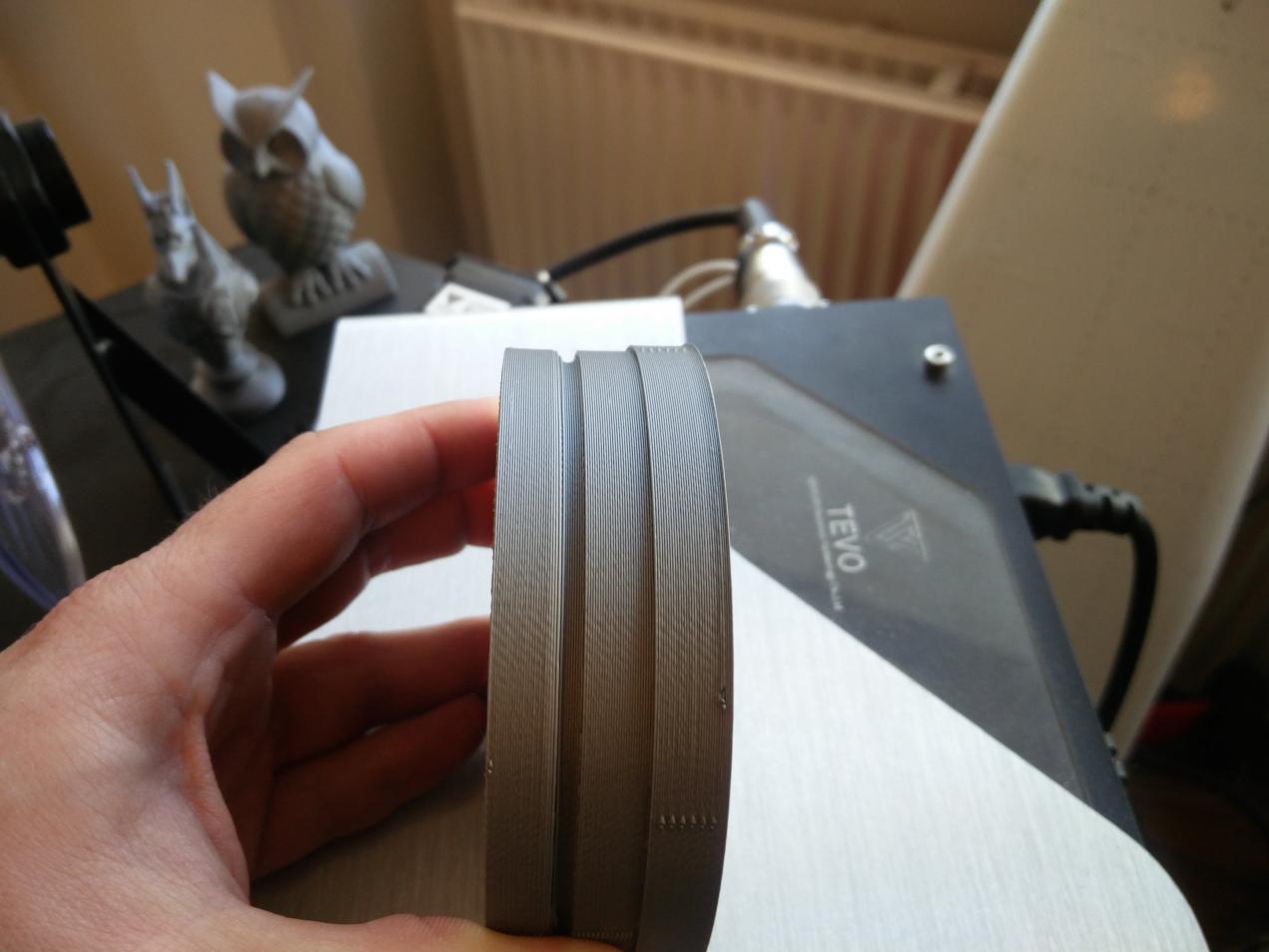

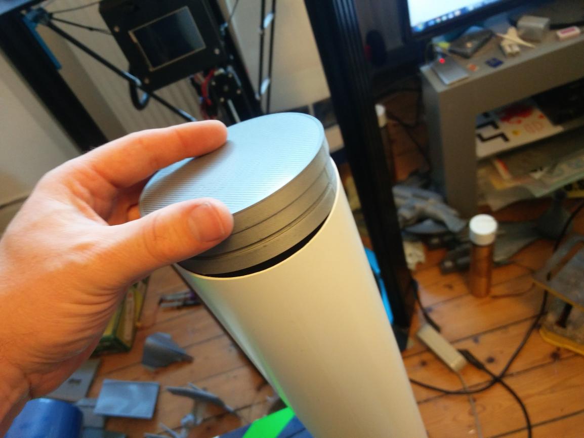

            I made a new endcap, but making it the exact size as the inner diameter is probably a bit tight..... I think it could seal the WTC even without an o-ring installed
            Made the groove 4mm wide, and square.
            Ordered o-rings on ebay.
