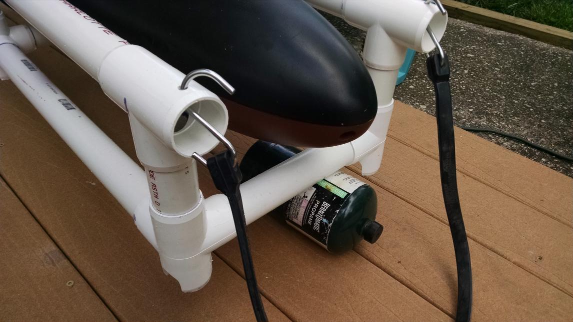

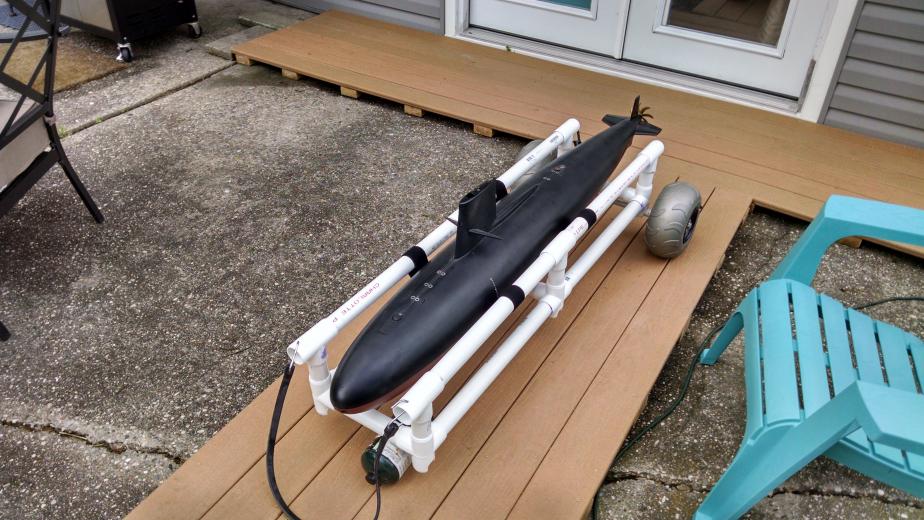

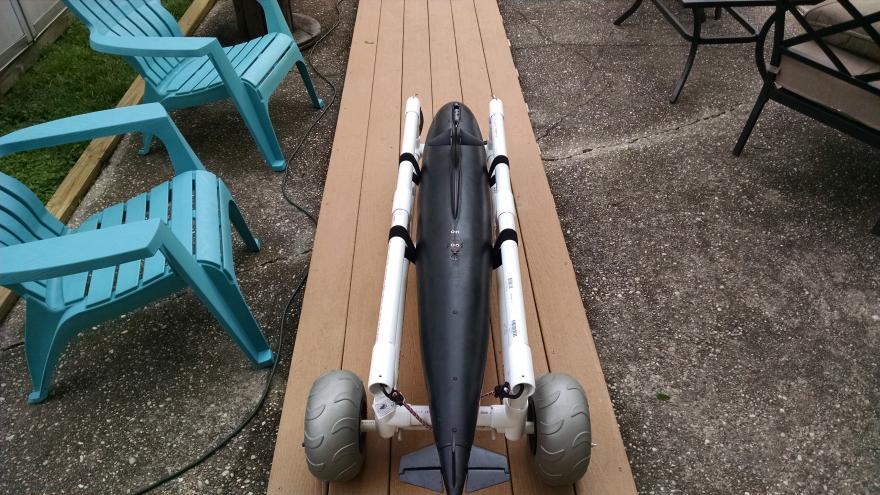

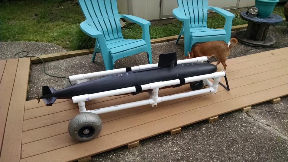

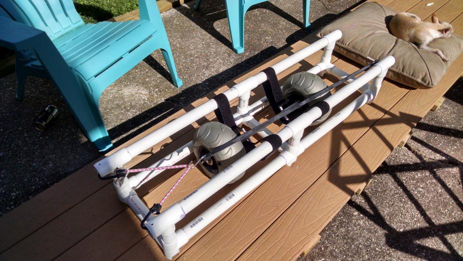

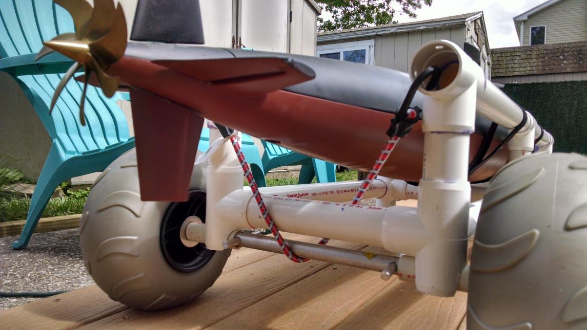

    With us getting older and my love for the larger scale boat never faltering, my back is having other thoughts.
    I present the Launch-Haul-System (LHS) for larger boats.
    Most useful in allowing those heavyweight hull monsters to drain as you haul them.
    Will accommodate most any boat up to an 8-3/4" Beam, most any LOA and a dry weight of ~60lbs. The 2" velcro straps are adjustable, move fore and aft, and the symmetrical design allows you to not be concerned with which is the tire end
    To Launch
    1-Roll the model into the water
    2-Remove the bungee w/wheel assembly (the over-sized sand tires make it buoyant)
    3-Float your boat.
    Have fun
    To Haul
    1-Float your boat onto the submerged LHS (It will rest on the bottom)
    2-Adjust the straps as necessary.
    3-Install the bungee w/wheel assembly preferably at the bow to avoid control surface/screw issues (remember the over-sized sand tires make it buoyant)
    4-Slowly haul the boat until it drains.
    Working on a skid set attachment design that will allow it to be launched at a pool, pond edge, dock etc that won't allow for the wheels.
