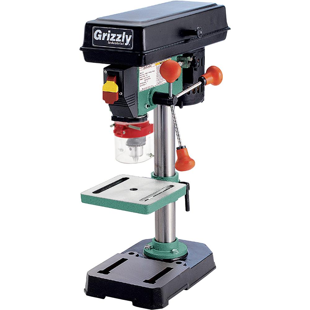

    I thought I would start this thread to get some input on what some good budget lathes and drill presses might be for WTC end cap construction. Subculture Andy, could probably chime in here, as he has done this kind of thing, numerous times.. With a few units like the ones I have shown, perhaps for the cost of one commercial WTC, you could buy these machines, and make your own WTC. Then you could make additional WTC units, for much less in the future. If you're only interested in having one WTC and one sub, this route probably wouldn't be worthwhile for you..
    This would also be good if you can't locate a commercial WTC unit that fits the particular model you're interested in building, and fits into the layout you'd like to have in your sub. Maybe currently available commercial units, don't provide you enough room for torpedo launchers, etc.. Or maybe you want a 2.75" OD WTC. Most commercial units are either 2.5" or 3.0".
    Another good discussion would be how to make your own motor bulkhead endcap. So that you can attach the drive motor or motors, of YOUR choice, to the endcap, with a propshaft seal or seals installed in the bulkhead cap.
    Grizzly Industrial, Inc. is a national retail and internet company providing a wide variety of high-quality woodworking and metalworking machinery, power tools, hand tools and accessories. By selling directly to end users we provide the best quality products at the best price to professionals and hobbyists.
    <h1>Grizzly G7942 8" Baby Benchtop Drill Press with D3655 7 pc. Forstner Bit Set!</h1> <h2>A fantastic, compact solution and great for miniature work! </h2> <p>Perfect for the small shop, the G7942 8" Baby Benchtop Drill Press won't get in your way when things get cramped. Constructed of cast-iron and only weighing in at 39 lbs., you can easily put it away on a shelf when finished. <p>The 1/3 HP motor smoothly and quietly powers the 5-speed drill press from 620 - 3100 RPM. With a max drill capacity of 1/2" through cast iron or mild steel, it can easily drill through fiberglass, plastic and composites. <p>The JT33 keyed drill chuck is fitted to the JT33 spindle taper. The chuck accepts drill bits as small as 1/64" to 1/2" to meet the needs of your various projects. The spindle has a 2" of travel as indicated by the depth gauge conveniently mounted on the headstock. <p>The precision-ground cast iron table is 6-1/2" square and tilts 90&deg; left and right. It swivels 360&deg; around the steel column and has two 5/8" T-slots, 5" on center. <p>Like all Grizzly drill presses, the G7942 comes with a 1-year warranty which covers parts and assures the unit is free from factory defects. (Consumables are not covered by the warranty.) <p>The G7942 manual was written by our U.S. based Technical Documentation Department and is packed with useful information. <p>The Grizzly Customer Service and Technical Support Teams are U.S. based. Parts and accessories for the drill press are available on-line and shipped from the Grizzly parts warehouse in Springfield, MO.</p> <p><font color="red">Made in and ISO 9001 factory</font></p> <p><strong>SPECIFICATIONS:</strong></p> <ul> <li>Motor: 1/3 HP, 110V, single-phase, 2A</li> <li>Swing: 8"</li> <li>Spindle taper: JT33</li> <li>Spindle travel: 2"</li> <li>Spindle speeds: 5 (620, 1100, 1720, 2340, 3100 RPM)</li> <li>Drill chuck: 1/64" - 1/2", B16, keyed</li> <li>Drilling capacity: 1/2" steel</li> <li>Max. distance spindle to table: 9-1/4"</li> <li>Table dimensions: 6-1/2" x 6-1/2"</li> <li>Table tilt: 90&deg; left &amp; right</li> <li>Table swivel around column: 360&deg;</li> <li>T-slots: (x2) 5/8, 5" on center</li> <li>Distance from spindle to base: 12-3/4"</li> <li>Footprint: 12-1/2" x 8"</li> <li>Overall height: 23"</li> <li>Approximate shipping weight: 45 lbs.</li><br><br>Free item wil not appear in cart but will be added to order

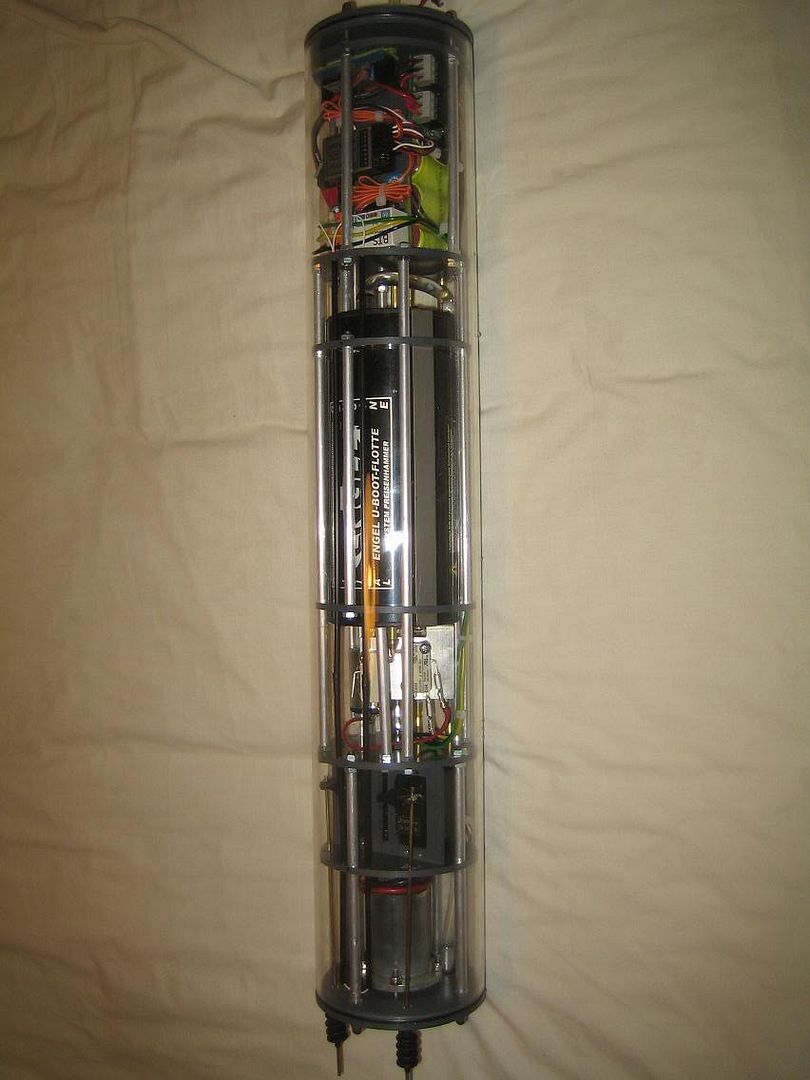

                  Your WTC reminds me of the OTW units, with an Engle piston tank, instead of the water pump. Looks like a professional made that cylinder.. Look at that neat routing of wires and placement of the components. This guy knows what the hell he's doing! I sure don't!
                      Ha, no I didnt know what I was doing. That was my first lathe and those discs were just about the first things I tuned in my life. I remember picking Andys brains on which one to buy and how to hold the PVC disc. Its really not difficult. If you can build a sub, you can make end caps and WTCs. My second WTC was a little more elaborate.

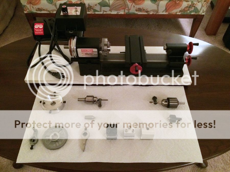

                              I picked up this Sherline 4000 Lathe, last Sunday, on the way home from visiting my mother. The lathe was about a 2.5 hour drive north of my home. My mother lives about an hour and 45 minutes north of me. The seller met me in a Sam's Club parking lot, close to where my mother lives, so it ended up being a convenient rendezvous.
                              He had a gasoline generator in his trunk, that we used to fire it up, so I could listen to, and watch the motor spin, to make sure that it ran good without any wobble or strange noises.
                              This is what I got for $400 :
                              Sherline 4000 with 2.5" 3-Jaw Chuck mounted on the headstock (made in California, not in China)
                              Including these extras]http://www.subcommittee.com/forum/icon_rolleyes.gif[/img] The only keys I currently have that fit them are the ones that are clamped down in the chucks.. Didn't realize I wouldn't be able to loosen them by hand, until I got the lathe home, oh well..
                              This lathe was bought new by an old man who passed away before he really ever got a chance to use it. The seller was a machinist, who bought it at an estate sale along with some other items. He said it was too small for him and he really didn't have a use for it.
                              To buy everything in the photo new, would cost at least a minimum of $800. So, it wasn't too bad of a deal..
