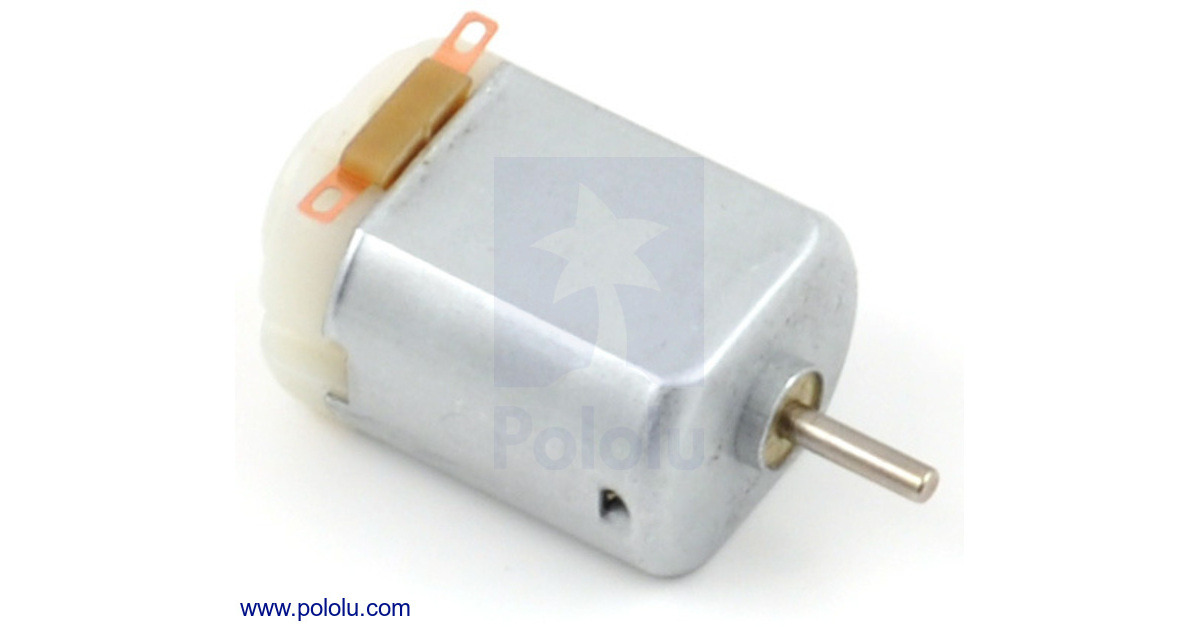

                  Re: 1/72 Type VII Motors Help
                  How these 130 motors?
                    Bit small. 180 is better.
