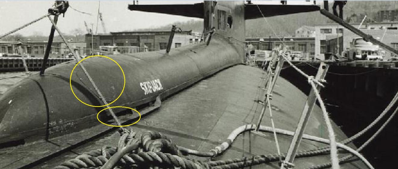

        I cant prove with clear photo's but I am conviced that MBT vents 4A & 4B are under the end of the turtleback exhaust cover. If you look at close ups of the aft end of the turtleback cover you can see there is a round access panel on each side which would be directly over the vents for maintenance. Also this position ties in with the schematics which have MBT vets 4A & 4B in this portion of the hull. I will try to attach a photo to demonstrate.

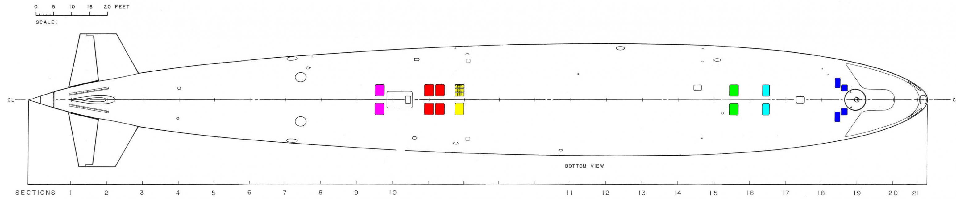

          I matched up Greg Sharpe plans to the one posted earlier and they seem to match up, here is my crayon drawing:
          The colors represent the sets the drawing above shows, what am I missing?

            Those inlets marked yellow on your drawing are MBT 4A and 4B inlets. If you look at the deck directly above those this is where you expect to find the outlet vents. That section of deck directly above your yellow markings does not have any visible vents in photos of Skipjack subs. But that section above your yellow markings includes the rear most part of the turtle back cover. This is where I believe you will find the missing 2 vents..underneath that turtle back cover (that area is all free flooding). That is why you cant see them in any photos. This is my theory about the missing two vents.

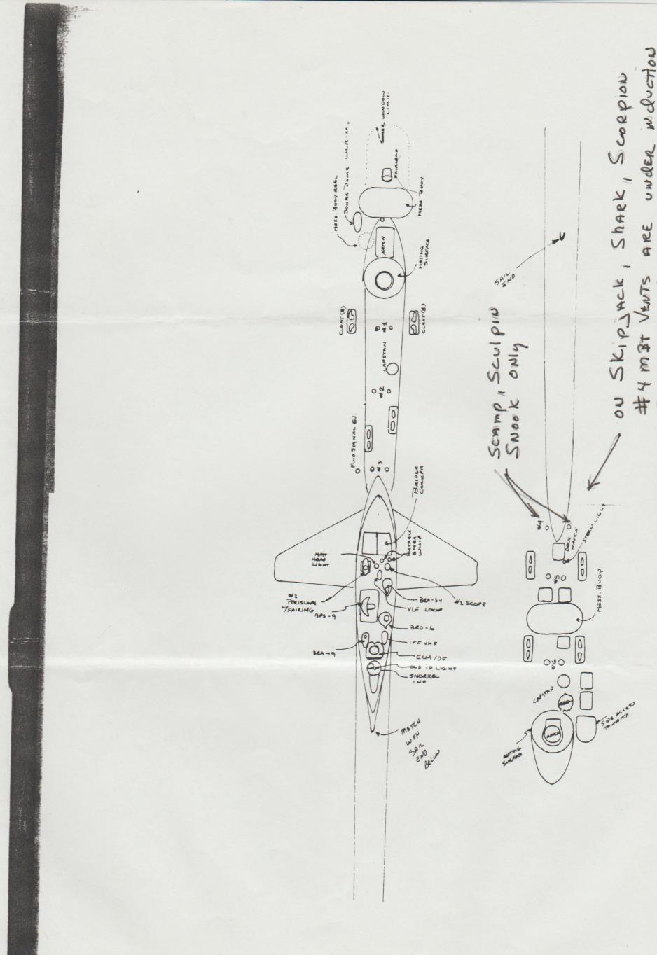

                    It looks like everyone is right. The vent in question was outside the exhaust housing and inside depending on the sub. This information came from Jim, I was told and I believe the hand-drawing originated by Ken Hart.

                        [ATTACH=CONFIG]3426[/ATTACH]
                        Uh-oh! Looks like my Snook is heading back into the yards for a re-fit. Thanks for that, Tom. More to learn every day!
