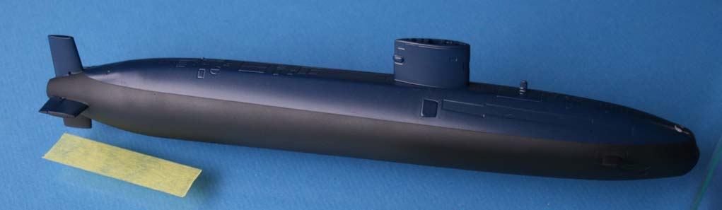

        I thought I'd show what I decided to do.. attempts and finding any real information were (unsurprisingly) unsuccessful so I guessed. One picture shows the approximate point on the bow; I chose the base of the fin as the rear point and aimed there:
        http://www.shipmodels.info/mws_forum/do ... p?id=27090
        Paint is 2/3 Model Master's US Navy Blue Angels Blue and 1/3 aircraft cockpit black. It color shifts as much as the real paint does too....
