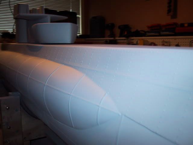

      I'm quite happy with the results I got, but I don't suggest you do it the way I did. Way....WAYYYYYY too labour intensive.
      I used 1/16 mask in 3 layers for the weld lines. Then I sprayed the entire plug with garage floor urethane paint (thick and very tough stuff) using my paint sprayer (the kind you would use for buildings / fences etc.). THEN....after letting the paint dry for 3 days, sanded the entire plug down again paying special attention to the raised areas of the 1/16 mask (weld lines). The paint built up nicely around the mask giving a realistic weld look. Again, the results look convincing, but it took me......a long time. My next build I will be doing it differently. I'd be very interested in learning a better way.
        Mylo
        It looks really good - great job. I agree - could be alot of work.

          It seems to me it took me a solid 12 hours of sanding my plug down, by hand, using teeny weeny circles, and lots of sand paper (the paint plugged the paper up quickly) again after spraying that heavy paint on. I literally got tendonitis in BOTH elbows. I was using some choice words, but at that point, was committed.
          Like I said, when the time comes to do another one, I'll be doing it differently.
