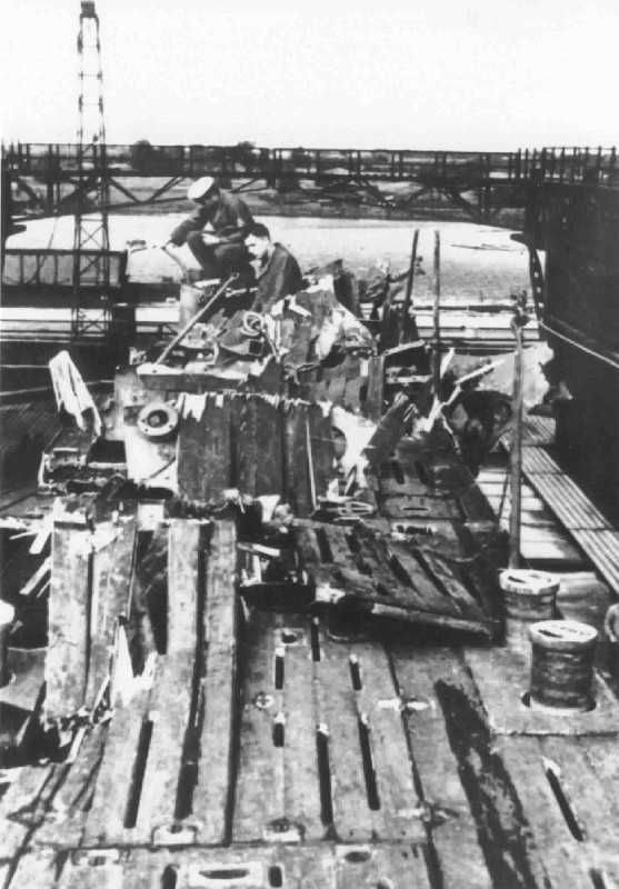

        Hi Mario,
        The decks of the Type VII were made from wood....except for the extreme fore/aft sections. In photos where you see the fore/aft deck painted a light grey....those are the metal deck sections.
        The decks of these boats were made by laying down planks and then adding in "spacers" between the planks. These spacers were rectangular in shape.....except that the short sides were concave. When inserted between two planks, this created that slotted deck look that is characteristic of the class.
        At some point mid- to late-war, they eliminated the spacers....but retained the planking. This simplified construction then created that late-war deck look.
        I have heard a number of ansers to the question of what wood was used for the deck. The most common answer that I hear is pine. This makes good sense as these boats were not built for long service lives.
        The wood decks that were freshly painted/treated had an almost black look to them. This color quickly faded to a dark-to-medium grey due to the effects of weather and saltwater. Boats that were out to sea on long missions often ended up with sections of the deck where the wood color would show through.
        If you have access to the book [i]Vom Original Zum Model] by Fritz Kohl, there is an excellent photo of a boat under construction where the individual wood planking can be seen. I'd have to check, but I think this book also has a photo of a boat with extreme damage to the bow...and the wood deck (spacers, etc.) can be plainly seen.

                    Hi Mario, I have just read your post and would like to share this photo which I only recently came across. The internet is so usefull at times. The photo is of U 35, Type VII A, built and launched in 1936. The photo was taken after U35 had been involved in a collision with Graff Spee during exercises. The damge done to her deck and casing caused by Graff Spees screw. The pic shows how the planks were laid as previously described and the fillets can also be seen, some of them have popped out.
