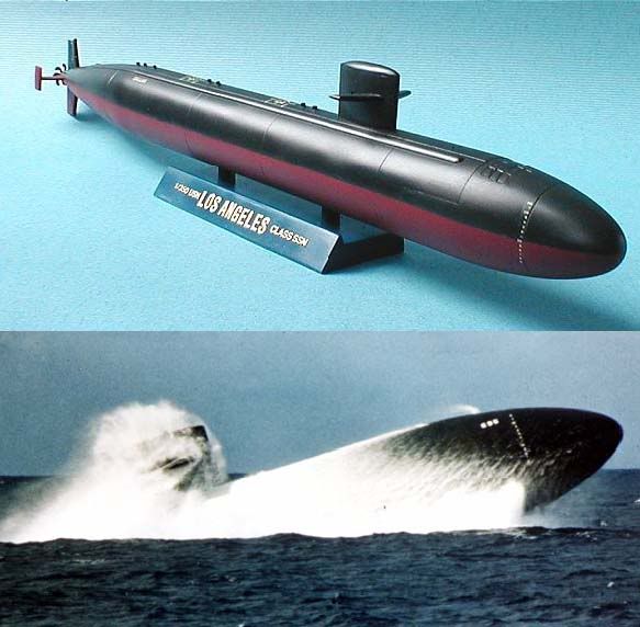

        I measured my model hull and did the maths - it seems to be made in an odd scale of 1/90. (Hull measures 48'' long and 4.5'' beam)
        Not sure if I want to shell out for a complete large plan set but thanks for the link Jeff.
        I did a bit of research into uss San Francisco to see why she has a different shaped bow ..Ouch! I see why now!
        My confusion over the bow shape is that some models seem to have a more rounded bow whilst others have a more pointed looking bow. The pointed bow is apparent in the spectacular photo of uss Birmingham doing the emergency full rise where her bows are well out of the water. So does that mean some of these other models have an inaccurate profile - if so what a big mistake to have the main profile so wrong!
        Here's what I mean..
