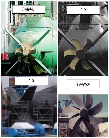

    I was looking at this photo from the launching of a 212A in Germany. The propeller looks fishy. Seems like the blades are covered by paper or cardboard. The new Revell 212 model has the same squarish blades. IMHO it's fake and the real blades are curved after analizing photos of the Italian 212 with it's prop covered.
    What do you think?

    Those are edge guards. The
    Those are edge guards. The edges of new propellers are usually pretty fine (thin), and they are covered to keep small nicks and other damage from occuring during installation. Keeps them factory fresh, and reduces nicks that cause the blades to "sing". The blades themselves resemble the older J series propellers on the Permit, Sturgeon and Polaris SSBNs. The J series did not have quite the same "sharp corners" at the tips, but they were overall very similar.
    See the two prop photos of the J series about halfway down the page on the Casimir Pulsaki SSBN]http://www.usscasimirpulaski.com/anatomy2refit.htm[/url]
    Why would one go to the trouble of putting fake propellers on a sub? Why not just shroud them from prying eyes?

      Hi Tom,
      Indeed, the italians launched
      Hi Tom,
      Indeed, the italians launched theirs 212 with the props covered.
      "Why would one go to the trouble of putting fake propellers on a sub?" To confuse? (at least Revell AG was confused by this!! )
      Why using edge guards with a fake bronze/brass color (they look like that) when the dunce cap is covered by a dark grey cover?
      The Russians showed their Lada prop in all it's glory except for the dunce cap which was covered by a nice golden cloth cap that is rather deceiving.
      As for the blades "resembling the older J series propellers": I would say that a good guess would be that they resemble the ones of the Dolphin class (with a fine tip) though a little bit longer.
      So far this is what I have:

        I concur. They are edge
        [color=#000000]I concur. They are edge guards. When the image of this 212 stern appeared many months ago, based on the blade chord separation at the base around the prop hub of the 212, for a minute or so I thought 'could these blades be variable pitch?'. I always wondered if this boat's AIP propulsion system combined with a computer controlled variable pitch for optimum underwater cruise endurance be possible, or even needed? I am inclined now, unless new evidence comes my way, these propellers are not variable pitch. It does seem to have less blade area compared to the Dolphin seven blade. However, the aspect ratio of the 212 blades is longer, (like a glider wing) for the most efficient lift to drag ratios vs. torsional strength. A blade on a propeller is basically a rotating foil shape creating lift sideways. This appears to be the latest wrinkle between when Dolphin's prop was developed, likely in the early 90's, and the 212, in the late 90's to early 2000's. Why the dunce cap is covered? The shape of the bell concave shape inside could be measured photographically, enhanced to 3D, then the optimal combination of speed vs. vortex attenuation could be theorized IE]

          I had
          Thanks Steve! Good analysis.
          I had that photo for a long time but never noticed the edge guards or whatever they are since a couple of weeks ago when I started to gather all the info on the 212 I got in preparation of the upcoming Revell 212.
          What do you think about those straight (sp?) corners? are part of the edge guards, are the blades curved on that spot?

            Follow the plan form in
            Follow the plan form in the image. No cardboard trickery here. Das U-31 ist ein schönes Boot!

              Thanks Tom and Steve for
              Thanks Tom and Steve for clariying this, it's a strange blade shape but very nice.
