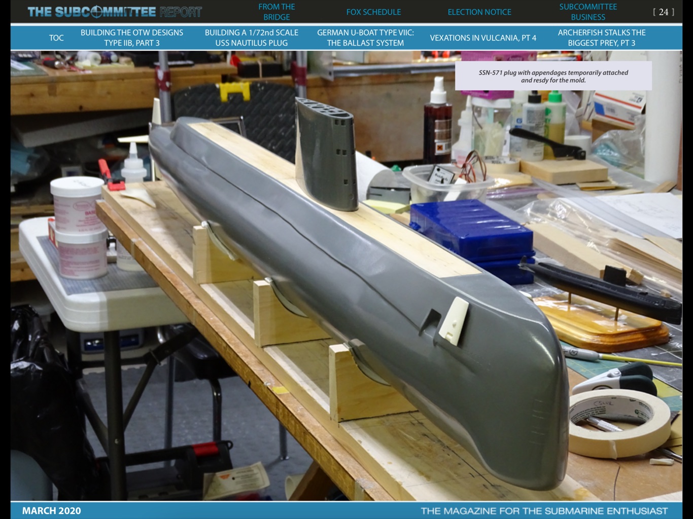

      Hi Jim,
      I would like to refer you to a build article I wrote for a
      1/72nd scale SSN-571 plug and surfaces I made. It is on page 20
      of the March 2020 SubCommittee Report. The SCR is in digital
      form and can be viewed on line.
      Don Spielberger (LoyalHanna Dockyard) is planning on making
      a mold and laying up some hulls for us this spring. (SubRon 8 )
      For my version of the SSN-571 I plan on making it a sealed hull
      with an Engel pump configuration similar to my Engel Lafayette
      Class sub I have. (SSN-629).
      Hope this gives you some ideas.
