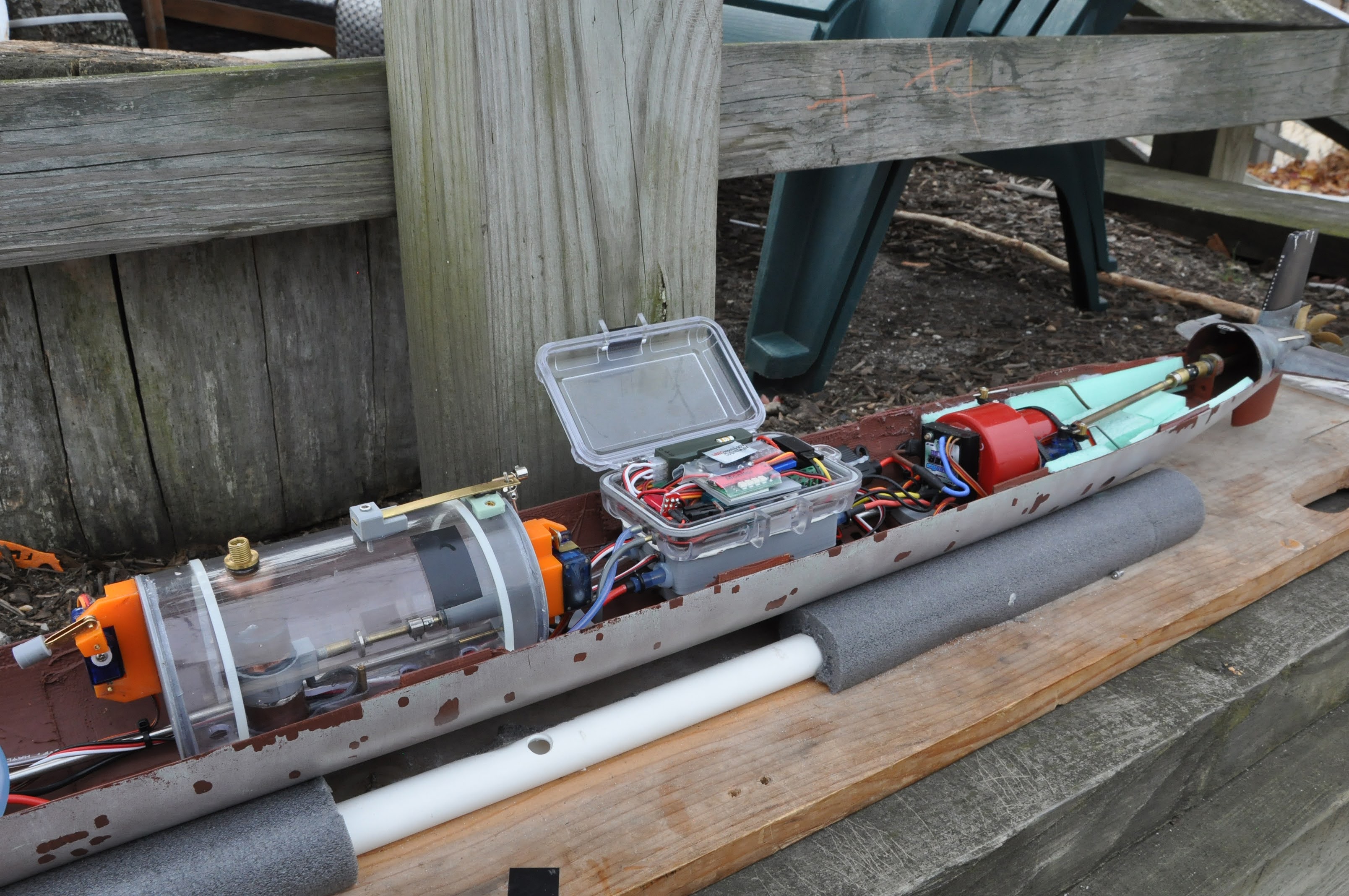

        I'm a big fan of running everything you can in the wet, IE, WP Servos, Speed Controllers etc. but NOT any exposed electrical component (IE, conductive materials/ferrous metals). touching the medium we play in.

        Unless you run in pure H2o, you have other elements in the water.
        Debris, biologics, chemicals, metal, salts etc.
        That exposed stud your power is connected to is one thing, but the solder joints in ANY motor (brushed or brushless), will deteriorate, and fail after a 1600 mile drive to a show. Wires, including the magnet wire of the motor, through capillary action, corrode over time. All that juice flowing through as you power along finds the shortest path to GND, and electrons dissolve.
        Also, any ferrous material in the water will be attracted to the motors magnets.

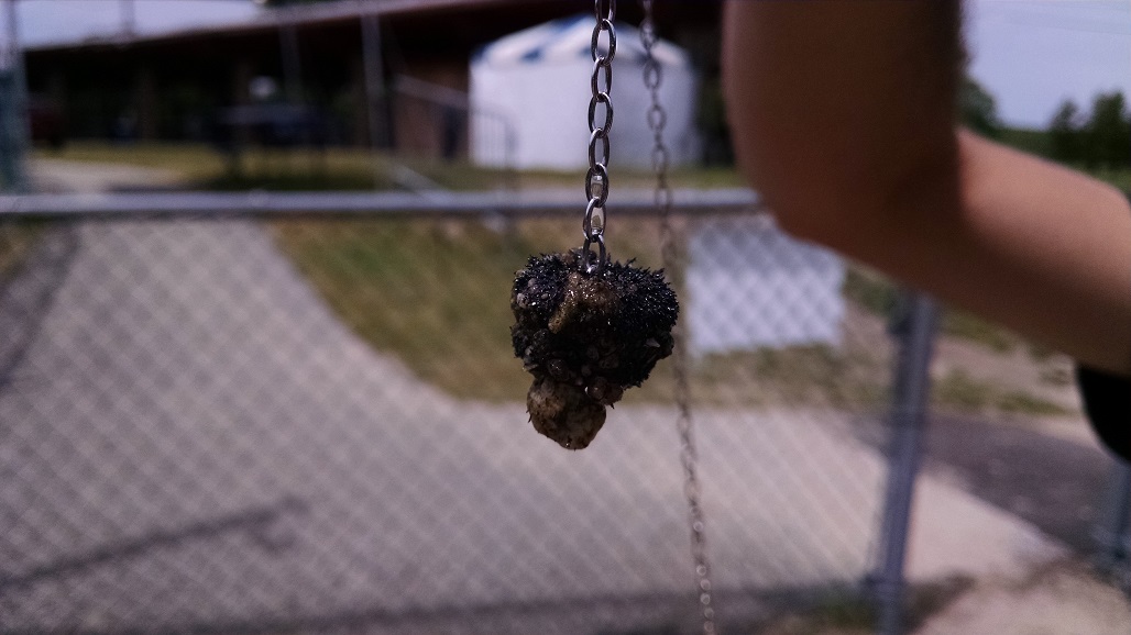

        Ever run at Groton? This is a rare earth magnet I used to moor the boat with (that's a piece of quarts below!):
        Your brushed or brushless motor will collect them, jamming it between those tight spaces.
