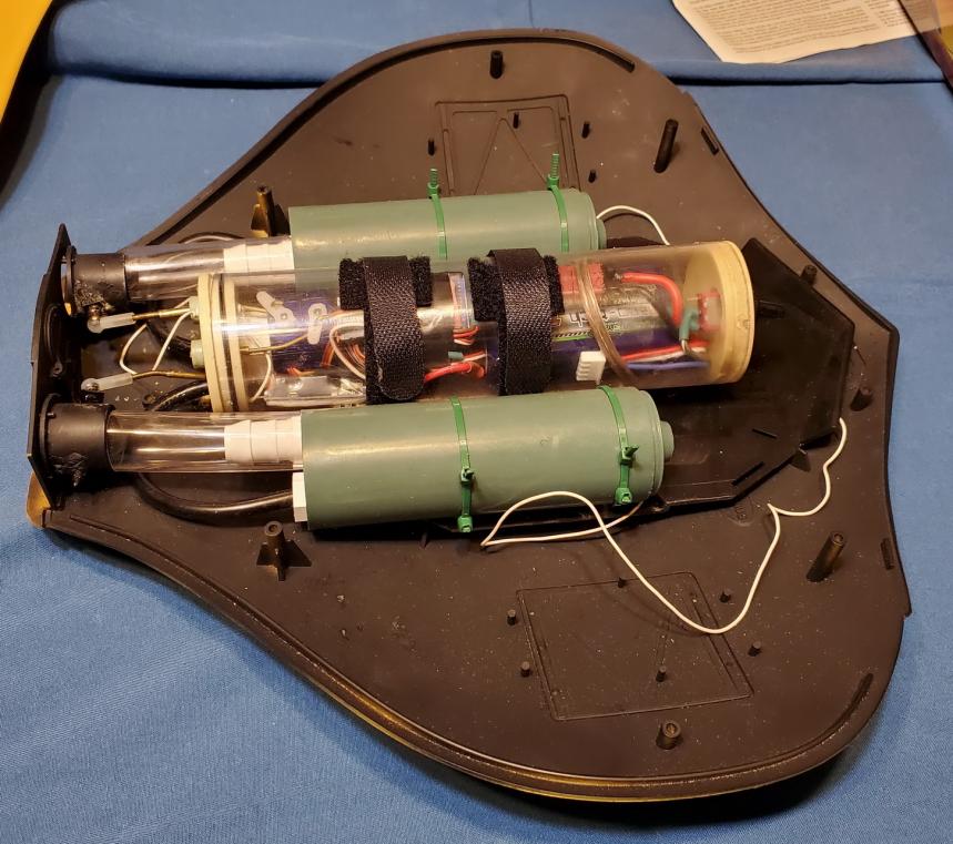

      Very beginning, waiting on sub to arrive. doing a lot of research and picking peoples brains. Here and Bob over on drydocks. I just have to see what I have for space before I go too far. I'd like to keep it looking original (within Reason)
        Subcommittee people have done some flying sub builds. Hard to tell who you are referring to without the picture. Rick Teskey is the expert on them and made his own molds long before the kit came out. Patty Osler built and runs her sub often. Big Dave and Crazy Ivan have built them. Some searches should come up with something. Big Dave had an article but I think he used a hosting site for the images (please don't don't use a hosting site, we have lost so much valuable info because of that). I have one started and can take pictures but have never finished the build.

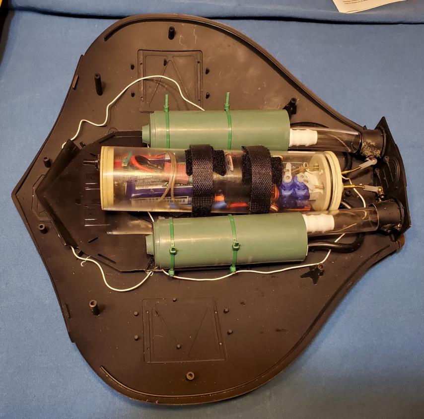

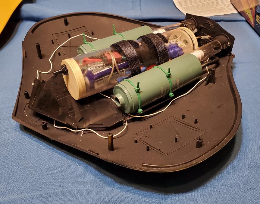

            Would love to see your pictures Bob
              Sorry it took me so long. Reach out to the Subcommittee members I mentioned in a previous post. They might not be on here often enough to see this thread.
                The drive units were mentioned in Big Dave's Moebius FS-1 build. Unfortunately he is not around anymore to help. Maybe we can reach out to his cousin, Don May, and see if he has any of Big Dave's images.

                  Bob, how do I search for the people you mentioned. Still trying to learn these boards. And thanks for the pictures. Are those a type of bilge pump?

                      Those look like a Rule brand pump, google Rule Pump. They make a few variants.
