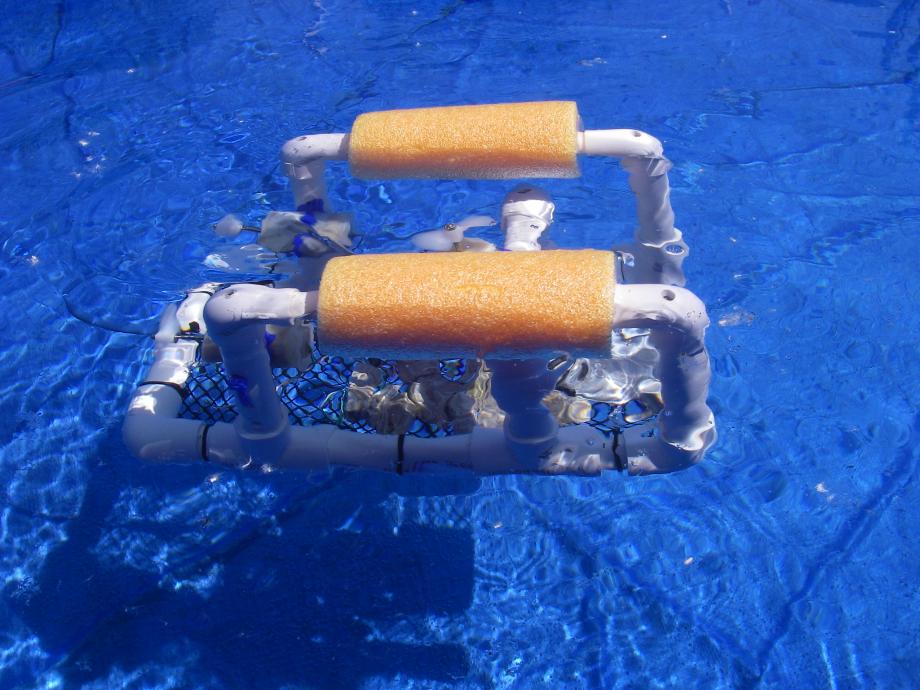

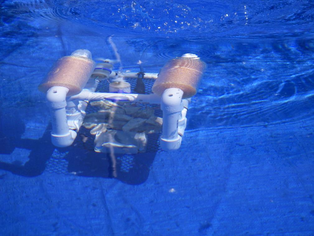

      Take a look at the SeaPerch program - here's a link to the build manual and videos. SeaPerch is a cable operated ROV made with PVC pipe; you could replace the ROV controller and cable radio gear, Since you're operating in a pool, the cable ROV might be an easier way to go. The SeaPerch has two horizontal drive motors and a vertical depth motor. Differential steering is provided by independent control of the two horizontal drive motors.
