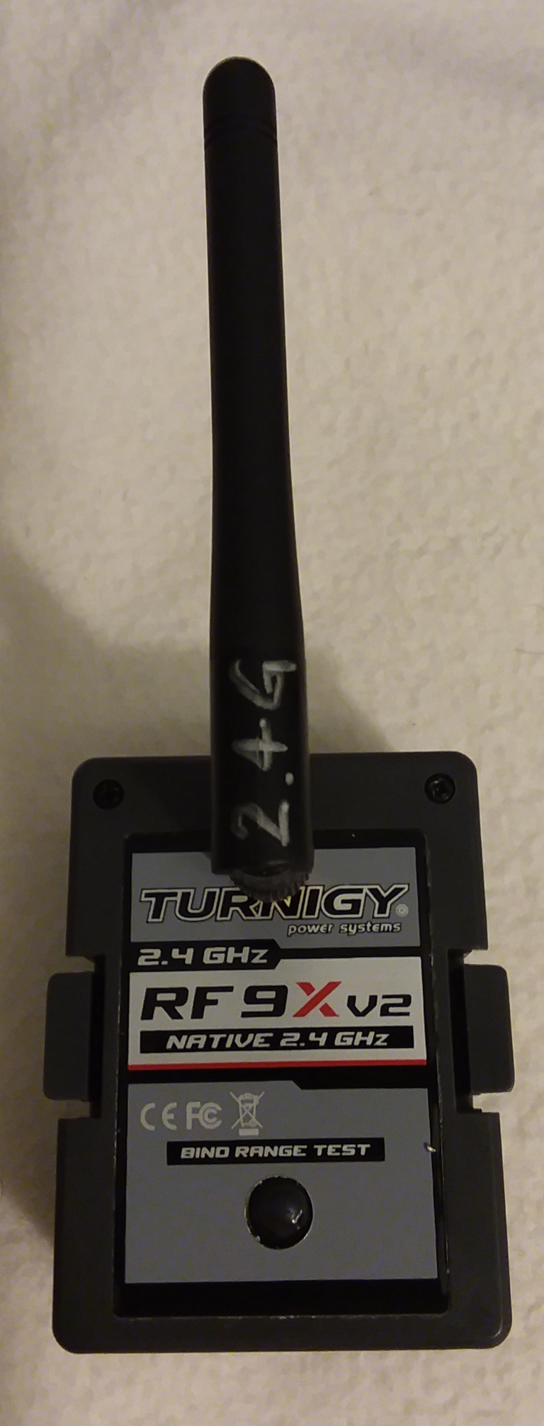

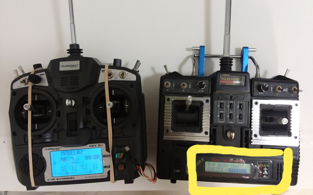

    Victim number 2, Turnigy 9X mode 1 to 2, removed 2.4GHz RF module and antenna. Add lcd back lighting, hot wire for loading opentx. All this are on YouTube how to videos. Not going over them.
    This transmitter frist comes out years ago as Flysky Th-9X 72MHz radio, today's box art still show the telescopic antenna. Market change it changes with it. For one thing Flysky doesn't have to do any RMA, everyone void the warranty by loading openTX frist thing out of the box.
    It so easily mod back to a 75MHz radio.

      DONE, go home. REALLY!

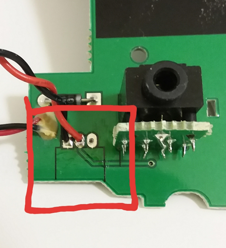

      Before we begin, CHANGE THAT BATTERY CONNECTOR!

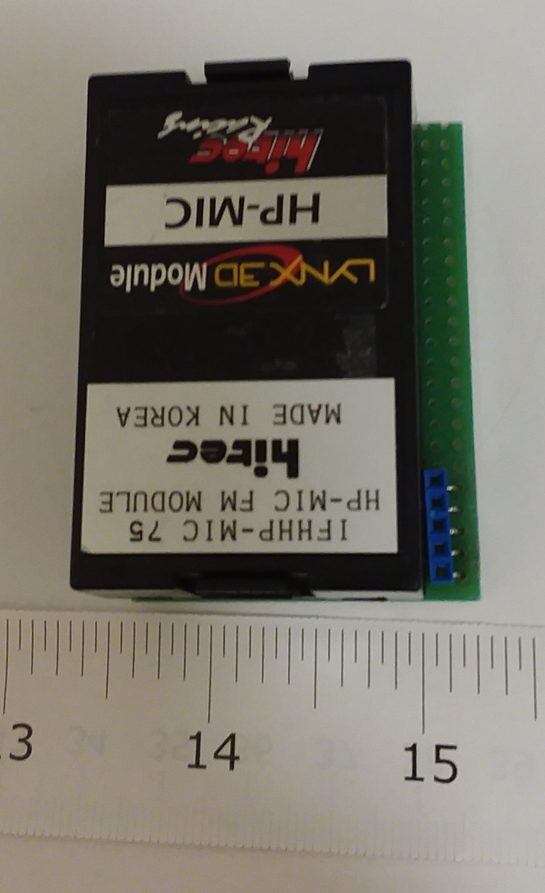

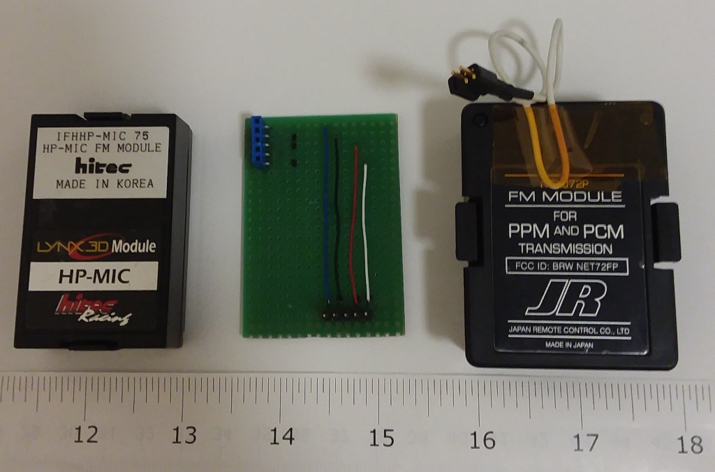

      It works with Futaba or Hitec and JR RF module . On the banch!

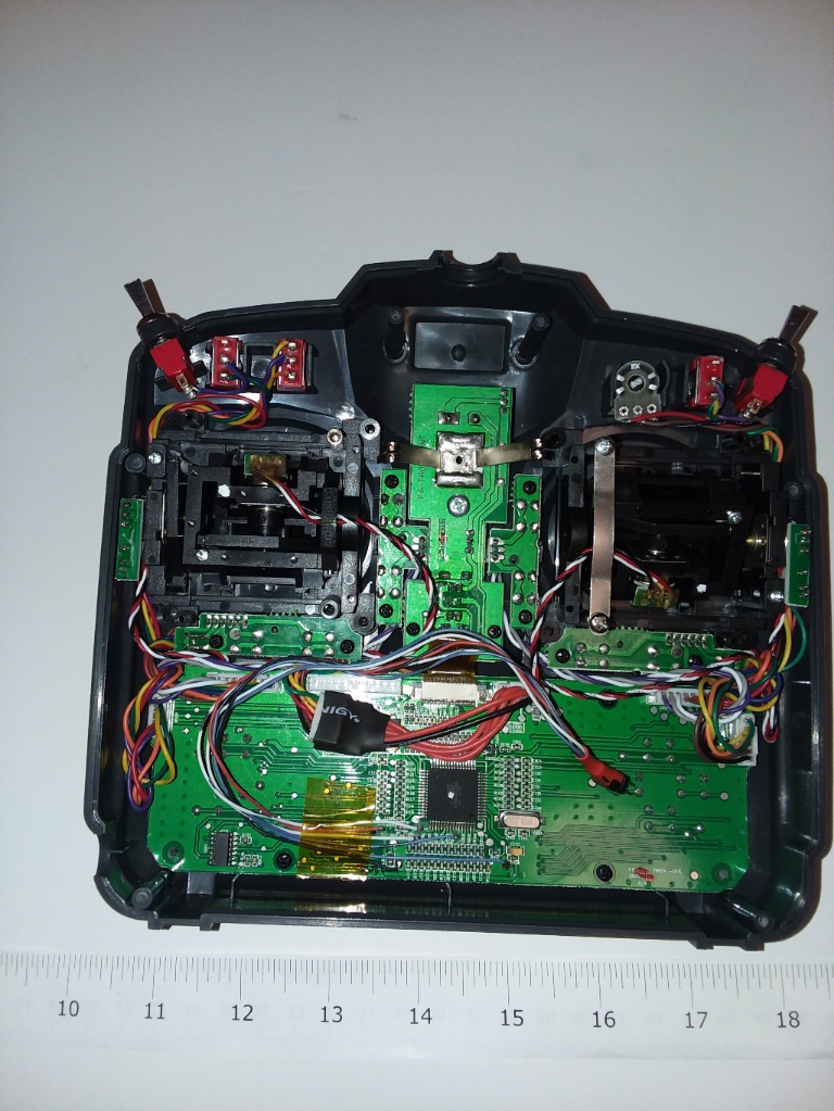

      Could use some help on this.

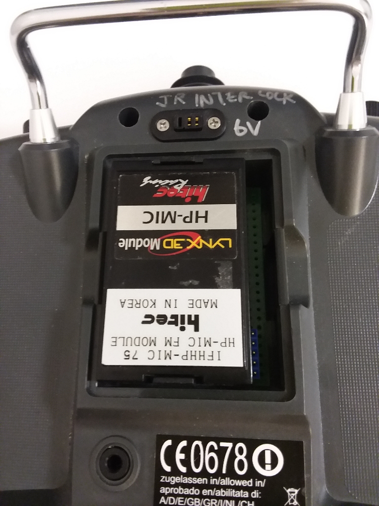

      Let start with the easy one Futaba and Hitec.

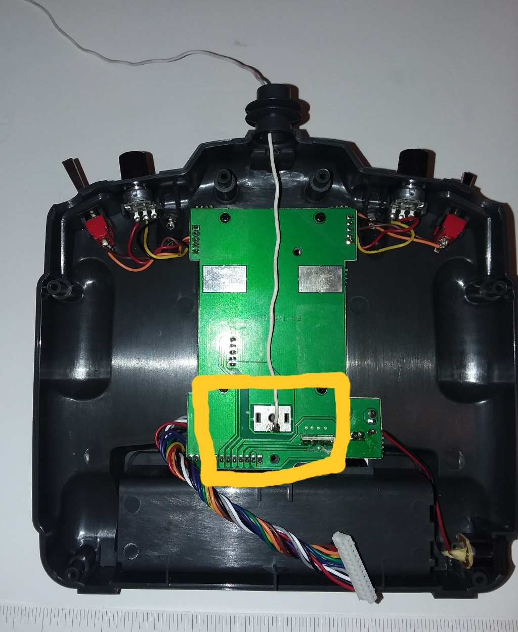

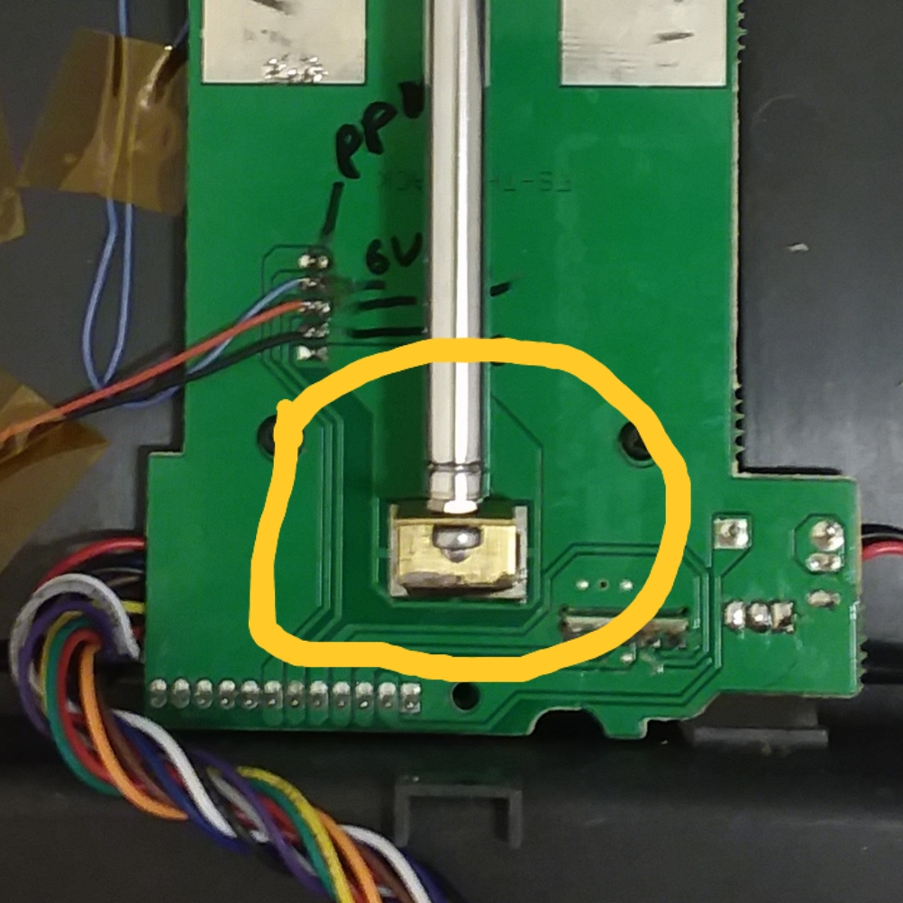

      Add back the antenna.

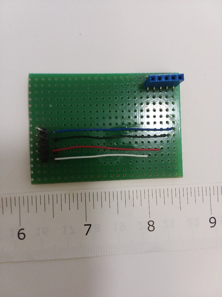

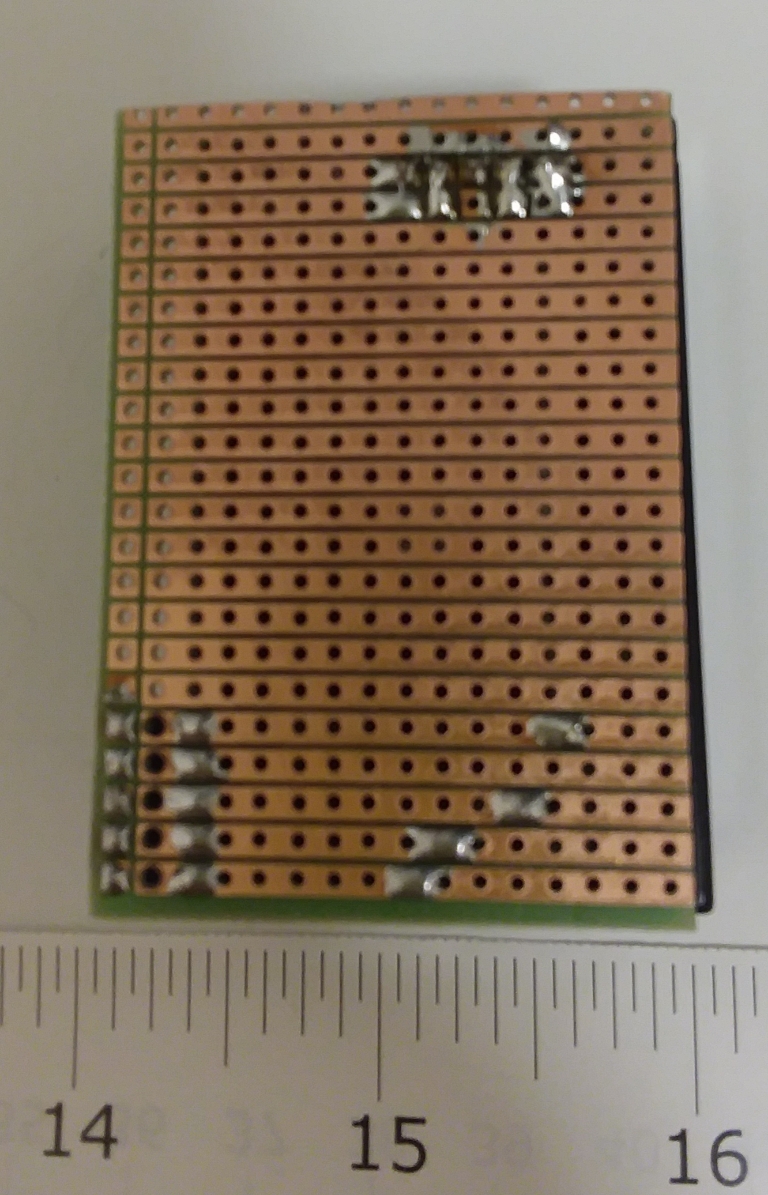

      Need to make a adopter board.

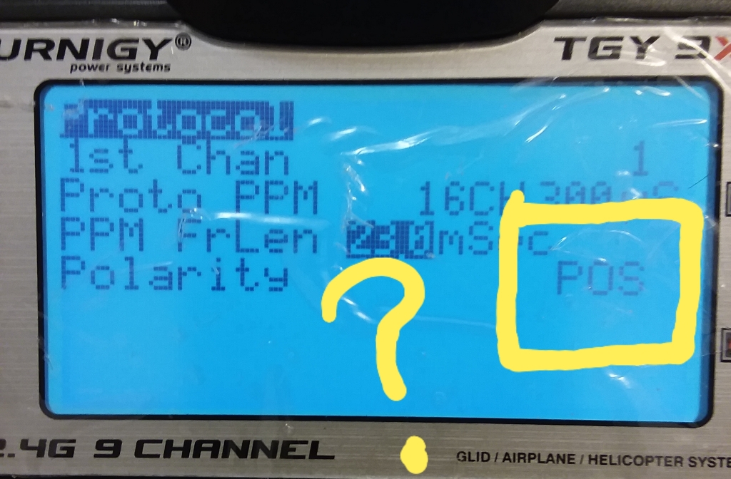

      ER9X Software bug?
      Set it to "POS"

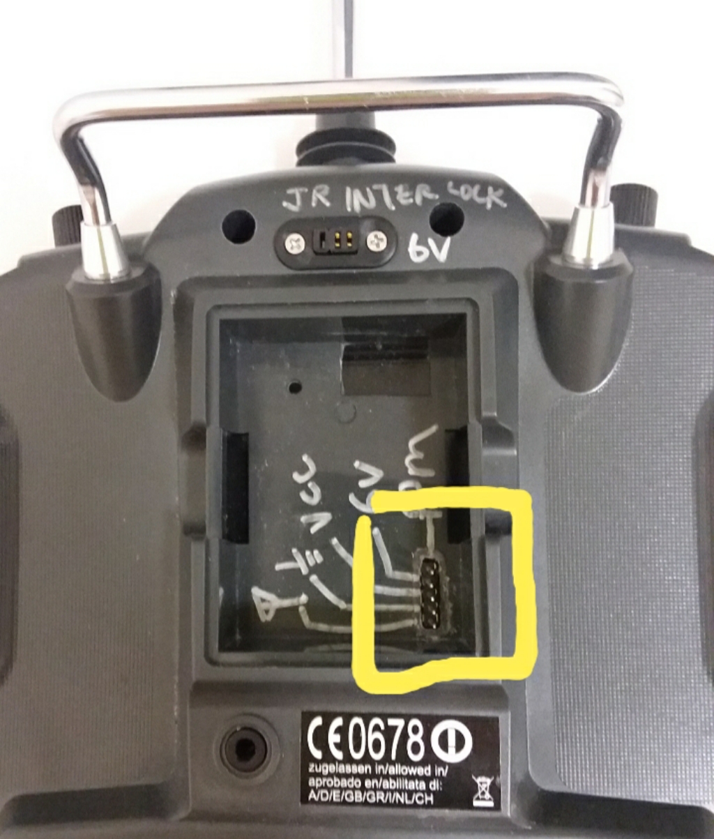

      So do the opposite on JR.
      Tracker II , Complainting. Most be good.

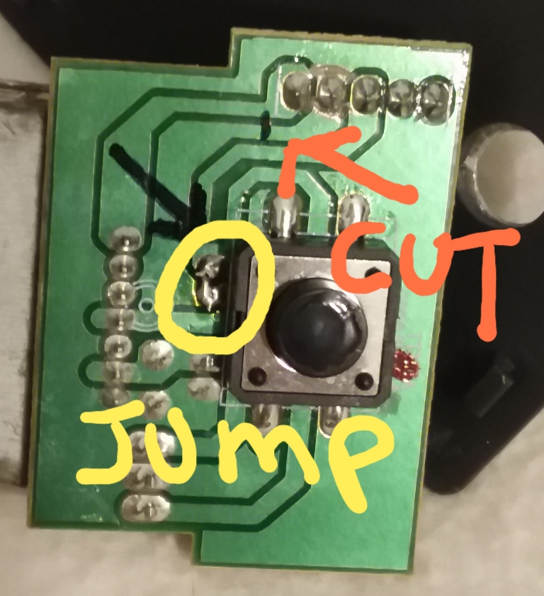

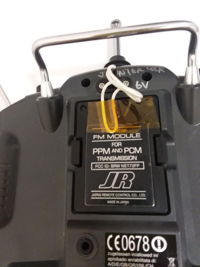

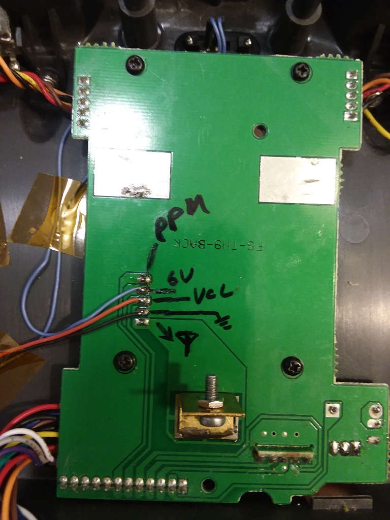

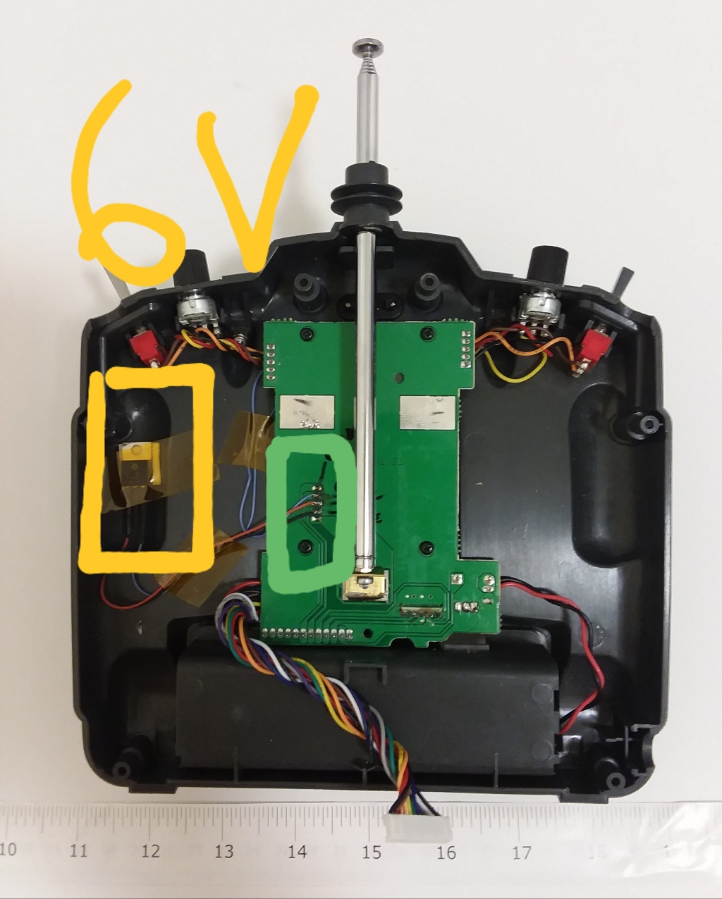

        JR module module mod. Abb back 6 volt to pin.
        If you just use the JR and flysky module. You don't have to cut down the hump at the connector.

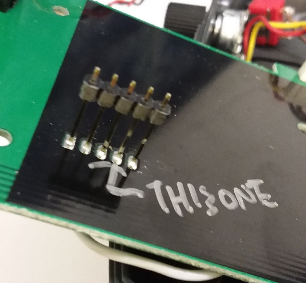

        Isolate the 6 volt pin.

        Front and back. Check it with a meter.
        Add back the 6 volt regulator.

        Now have to make the Flysky module work.
        Do the fix.
        New antenna, back in business.

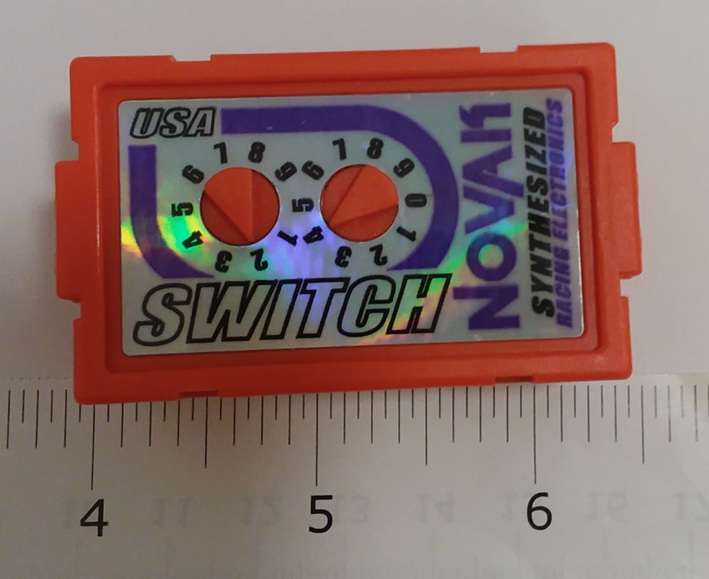

          Tie up some lose end.
          Novak synthesized works, with some rewiring.
          All JR receivers are working.
          Nothing wrong with software, just how I shoe horn the crystal. Find more receivers will works with it.
