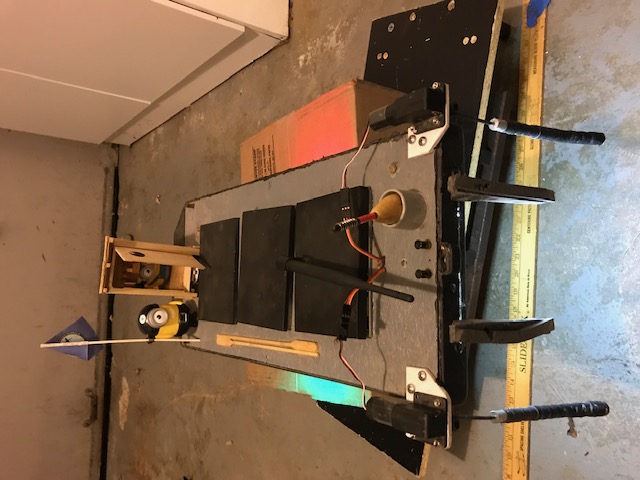

              I have a motorized barge that works very well and has many rescues to it's credit. I even added some servo retractable landing gear from an airplane as deployable push bars
              . They extend well down below the surface and can cradle the side of a sub. The drive is a steerable 380 motor pod that can turn about 100 degrees to either side. I will posts some pictures soon

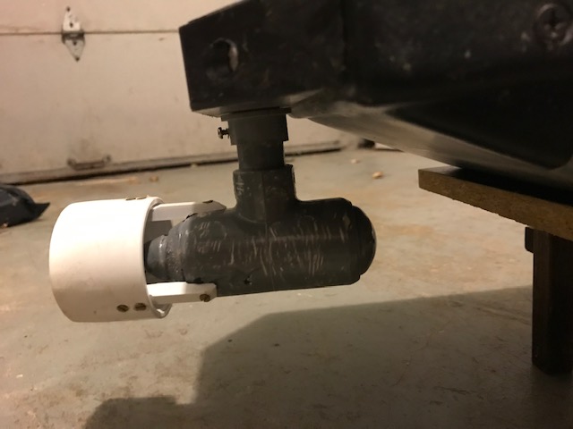

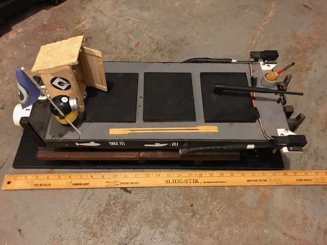

                  So this is my rescue barge. It is built on an custom polycarbonate electrical box cover. The cover is about 1/8" thick and crystal clear. The motor is a 380 type direct drive in a pod made from pvc plumbing fittings. Originally I built this with 2 small drives from one of the cheap yellow subs with rudder servos directly on top of each drive and controlled separately. there is a rudder servo under the throne room (outhouse) using a cable drive pulley that was salvaged from an old glider. It also has a servo extender to increase the throw of the steering to about 100 degrees left or right.. The cover has a built in lip that I used to glued and screwed some scrap wood all the way around and then I attached a simple plywood deck. There have been several mods over the last 5 or 6 years including a fpv camera that currently looks down thru a clear area of the hull for search and rescue. Greg
                    • 364
                    this barge has pushed in many boats. On it's first outing alone I performed 5 rescues. It always goes to the pond with me . It has even gone to Carmel . But on a good day it never gets run and I'm fine with that.
                      I like it.
                      It is basic and has the needed items to make a rescue.
                      I was thnk a barage shape like an old cement mixing trough box.
                      Don't think it even needs the ends tapered up.
                      Just plow through the water.
                      I would not have thought of a motor pod.
                      No rudder required.
                      No propeller shaft or stuffing tube.
                      Good push bars up front (pads) and something to let down or up to capiture the sub or other stranded ship/boat.
                      And in this situation, "No" is a good thing.
                      Some where I have a photo of a river motor barge.
                      It has a steering stand at the rear having just railing around it. (now cabin structure)
                      It might have been and empty car ferry barge, come to think of it.
                      Thanks, Greg.
                      Gives me something to think about.

                            Greg, a question.
                            What is the propeller diameter?
                            I have a couple to choose from but I think they are too big.
                            Trying to scale your pod to the hull gives me a diamter of about 1" or maybeeven 3/4".
                            This is a rescue barge so speed is not a issue but push power might be.
                            I am thinking a 4 blade propeller but that may be more than needed.
                              • 364
                              #29
                              I used a prop that vac u tug sells for their tugboat. http://www.vac-u-boat.com/KitsParts.htm I think its a 1.75" three blade. It only has a 380 motor inside. Originally I ran the prop exposed but later used a pvc fitting as a nozzle. If I remember correctly the pod started as a 1" pvc tee with a 1/2" branch. I then used reducing fittings and a cap and sanded to a rough shape. The whole thing started as a tinkering project to see if I could do it and was just to push my camera system around.
