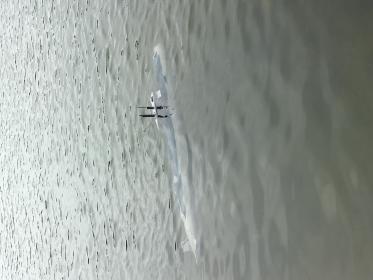

        Small turnout for our run yesterday, but a nice time anyway. I got to run both Mike D’s Akula and Will’s Walrus. Ralph tinkered more with his Skipjack, and made plans with Will for more alterations to his new Engel boat. I picked up more experience handling a radio featuring twin sticks on the left side running a boat with a piston tank—after running it wrong for quite a while first. Live and learn. Onward and downward. See you next month, guys!
        Here’s Will’s Walrus under my still-inept command. But I’m getting there!

                      Now some photos.
                      Unfortunately they are of the Skipjack early in the morning.
                      .................. Skipjack run ..................
