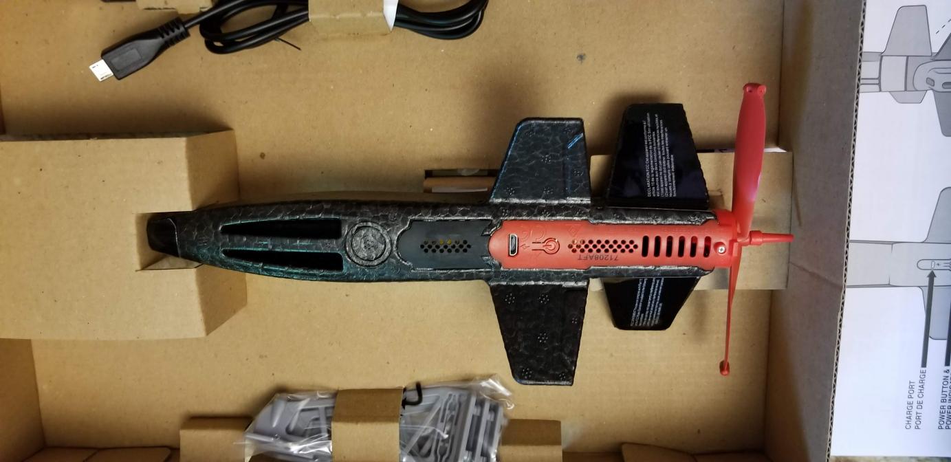

                          Picked this up at Toys R Us for around $12. Think the guts can be transferred to power a torpedo very easily.

                            cheers Bob Martin did some torpedoes with a timer and capacitor drive they were posted on YouTube . h
